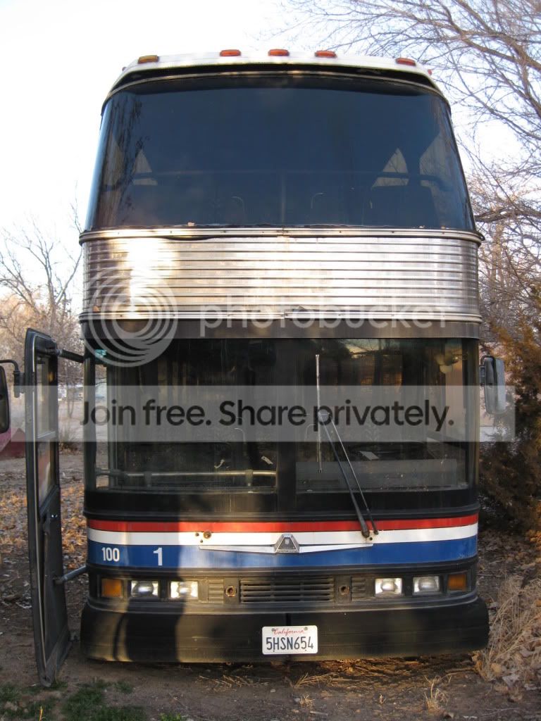

   Well guys, I have come across an MCI 5 that I hope to look at next week. If its something I can make work this could be the one. What I know so far is this Bus might have never been a seated coach. The seller says its an older conversion and has sat for quite some time. He was told it originally belonged to Mel Tillis, but nothing proof positive. Its a bunk bus, so maybe just for band members. The seller really knows nothing more about it, I will have to figure out the rest on my own. And myself, I know didly squat about a -5, I dont know if I have even even seen one in person. There are tons of sites telling me what to look for on a 7-8-9, but nothing about a -5.
   I dont yet know what engine or gearbox it has, and neither does the seller ("its a diesel"), but I am assuming 8V71 w/4 speed manual. Many of you know I have a heck of hill to climb to get up to my house, so I am not sure this big old dude can make it with the 4 speed, but installing a 7 speed is doable if need be and I could park it off site for a bit till I can alter it. At any rate, I have a feeling I can make it so we wont talk about that for now.
   So onward through the fog...I know these are said to have rust issues. Does anyone know where to look to see if its a problem? Any site I can go to that describes where to look and what to check?
   I know enough to check the big stuff, steering slop, look for integral steering, etc., but a good primer on a -5 would be very helpful. I'll get more information from the seller, but if y'all have any specific questions I should ask I am all ears. I dont want to get my hopes up, but I am kind of excited to see it.  Heres a pic.

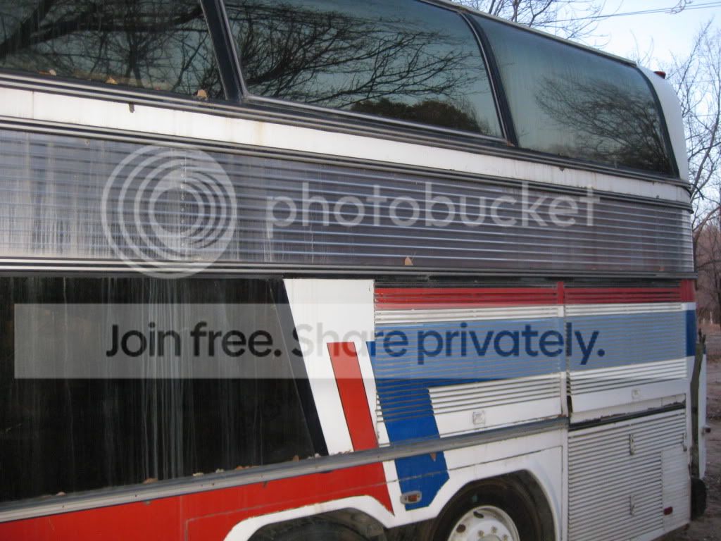

Check for rust on the frame at the front in the spare tire compartment.  Check the frame and cradle around the engine. Also up above the engine around the rads. It will have rust below the windows because they always leak.

Mine is a Saudi Bus 5C so it only has the 6V-71 but the a's have the eights.. I agree below the windows if they are original which they look like yo  will have rust depending on were it has been. You can tel by looking down the side to see if it is wavy or not or look for big spots bubbling paint etc.
