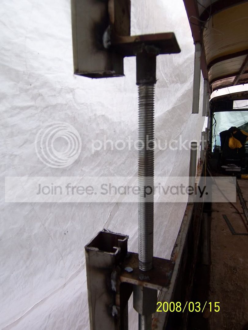

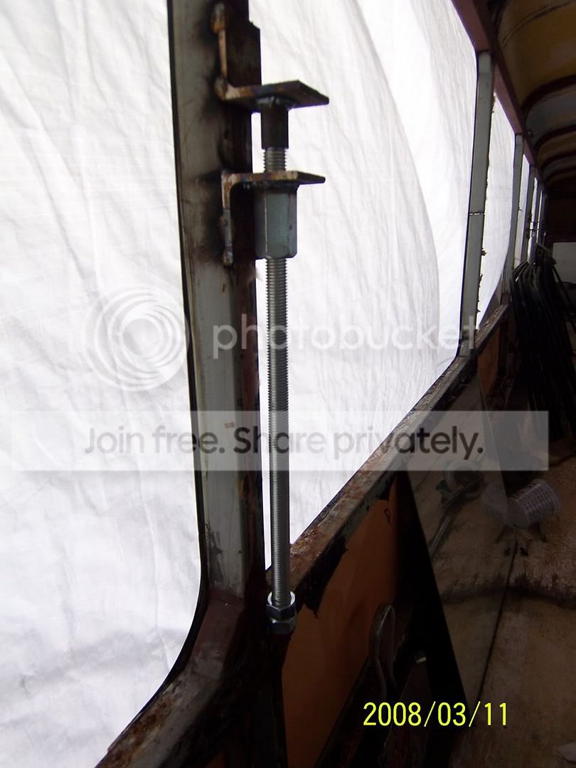

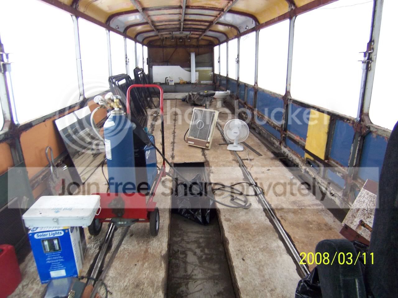

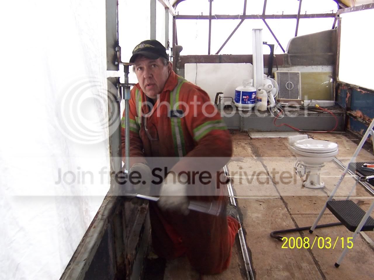

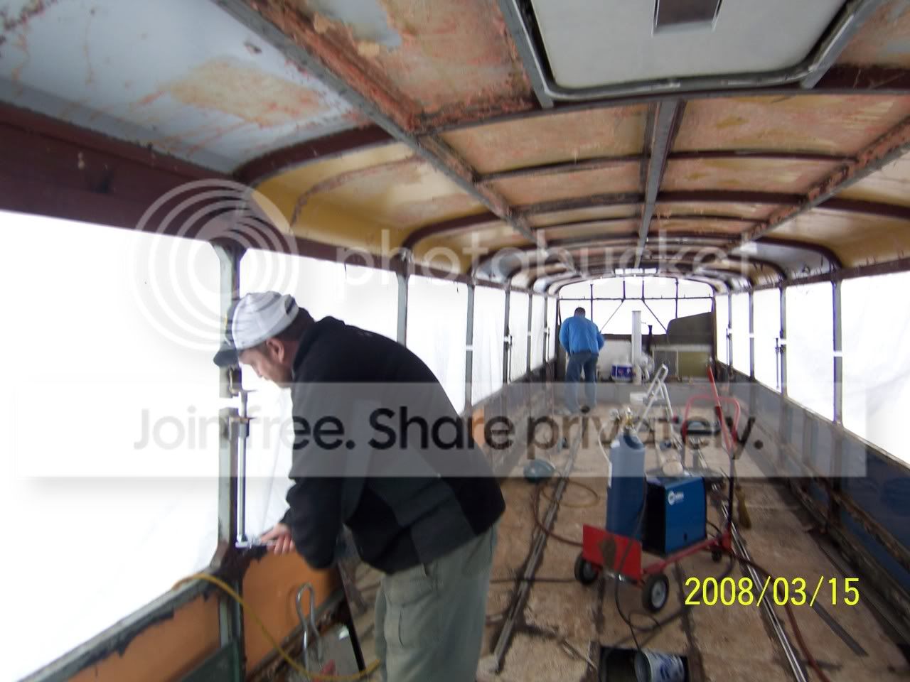

so we began the project of raising the roof of my MCI 102a3 today.  here are a few of the progress pics as of tonight.
the coach as it began in the morning

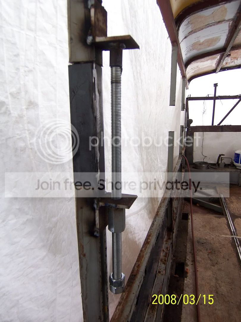

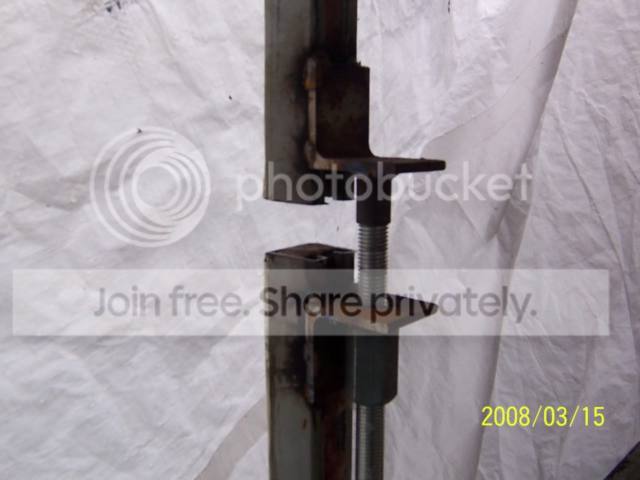

the raising bracket assembly that we fabricated
after the cut was made and roof was raised slightly
this is me raising the roof.  on a side note the brackets worked flawlessly
here is a couple of my buddies lending a hand
here it is raised the 8"

I made my lifting brackets a little different, but I like yours better.

Now that is a very cleaver way of doing the raise.  I'm glad to see that those threaded rods were strong enough to keep the roof from moving or falling on its own.  Lot's of work ahead!  Good Luck, TomC
captain ron
Nice project and pictures.  I wish I had taken pictures of mine.  I like your jacking method it's rather ingenious. The way I jacked mine up was I built 4 beams that spanned across the bus and 2 sat on the window sill that runs the full length of the bus. I put one up front and one in the rear. Then I set 4 jacks (1 at each corner) on them then put the other beams on top under the roof frame. I put square tubing in the existing channel that fit perfectly. This was done on 4 corners of the bus and kept the roof from moving in any direction but up or down.

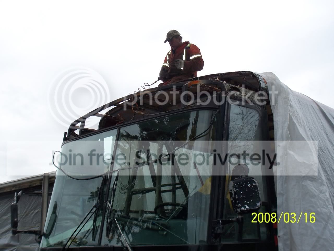

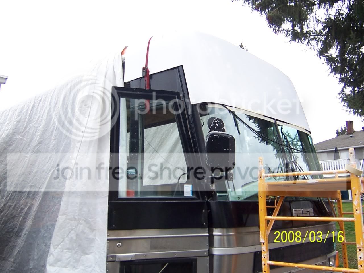

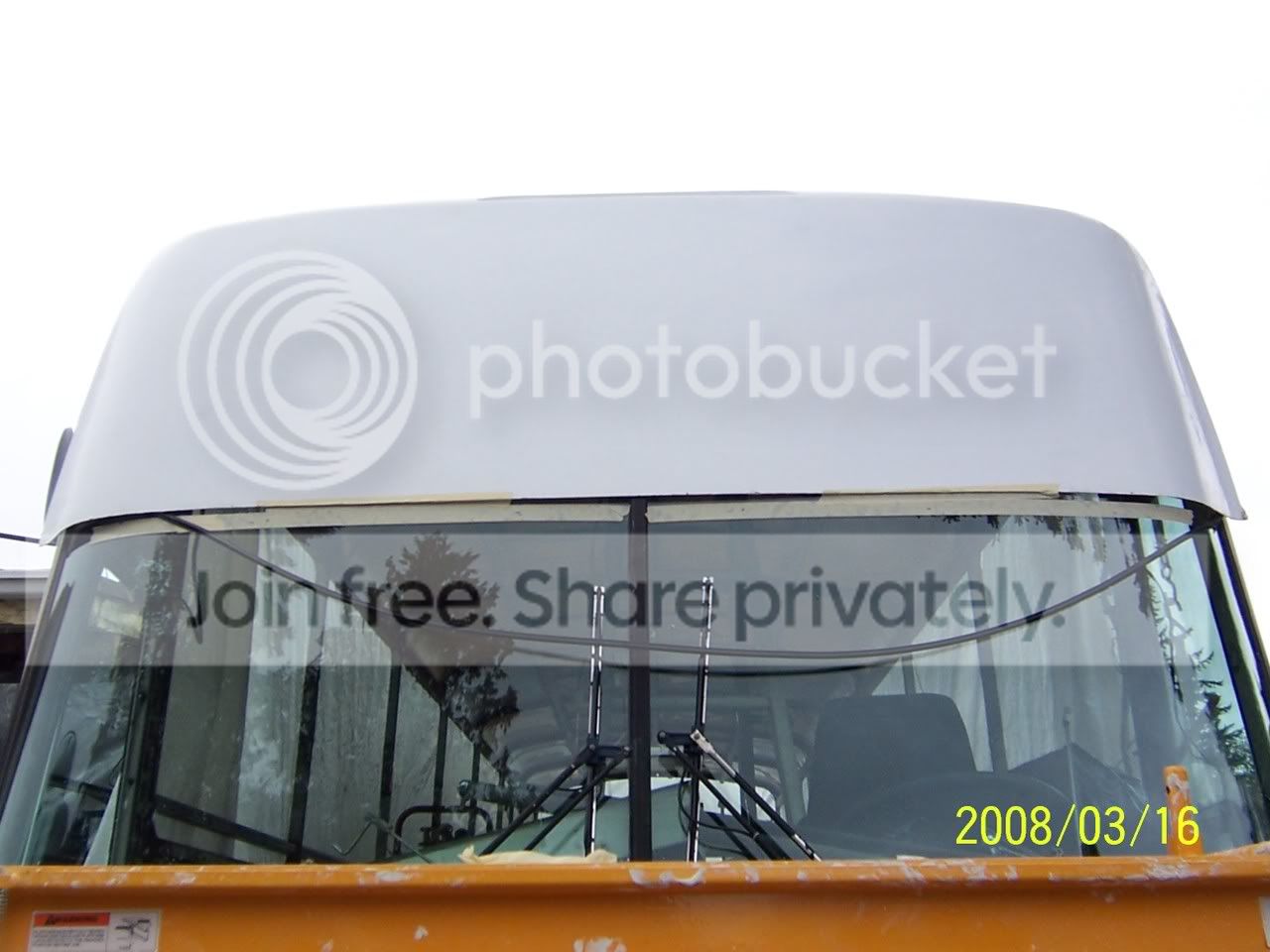

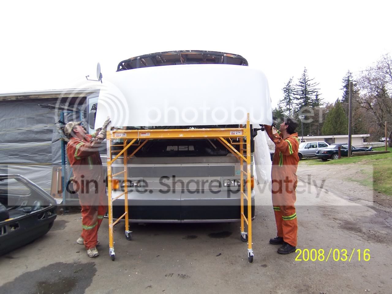

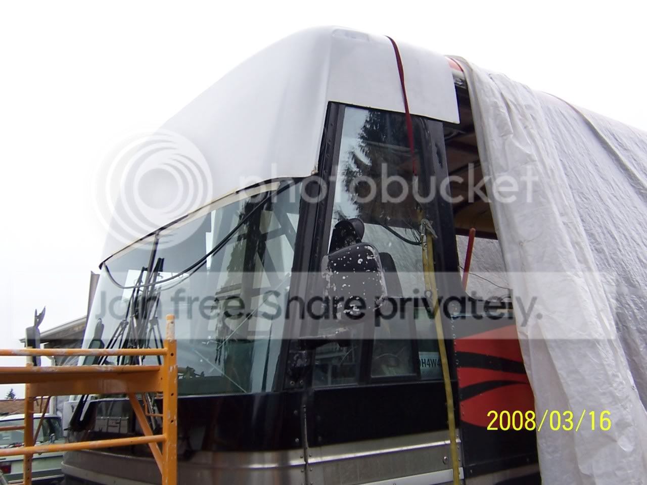

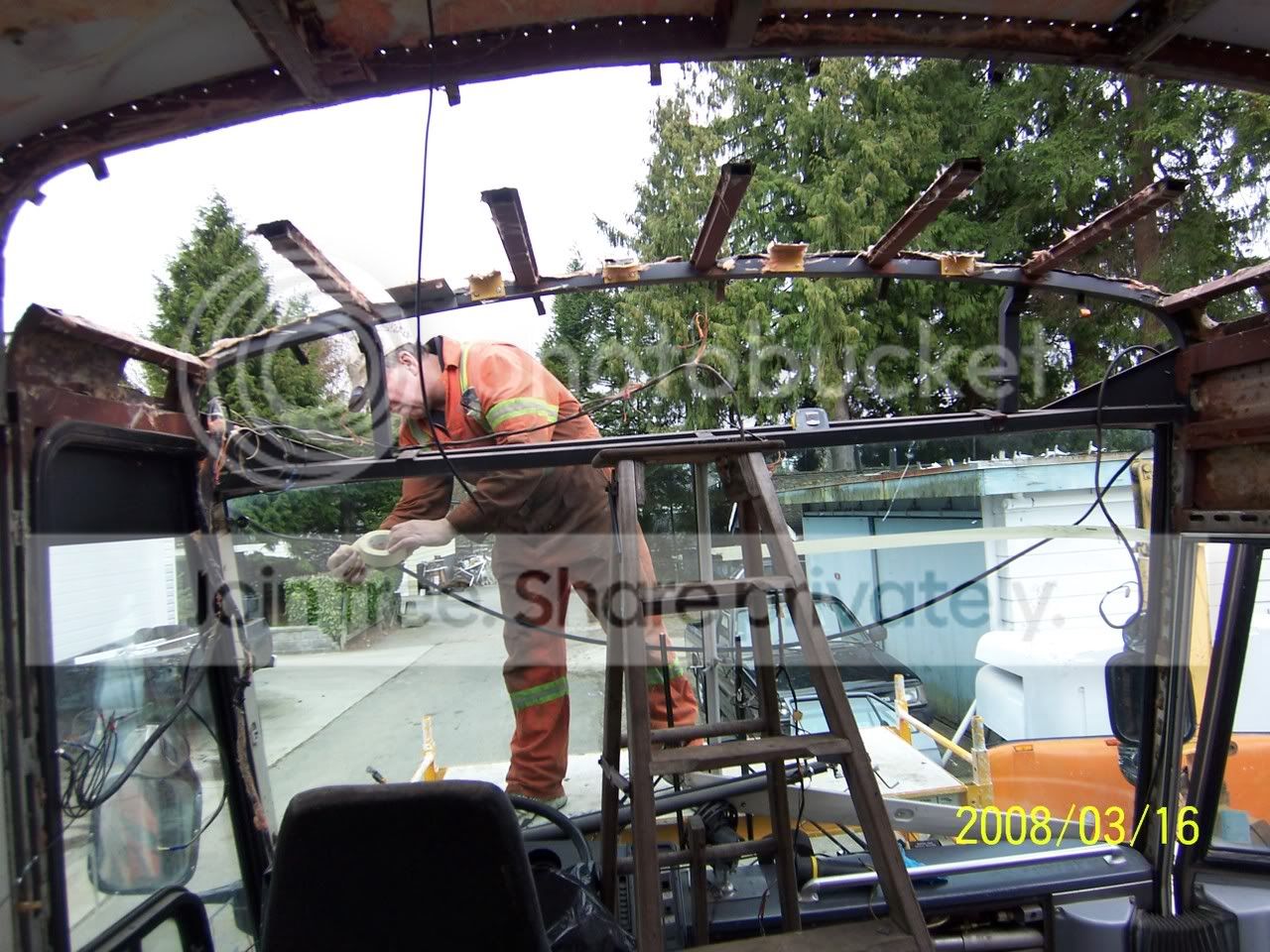

todays progress

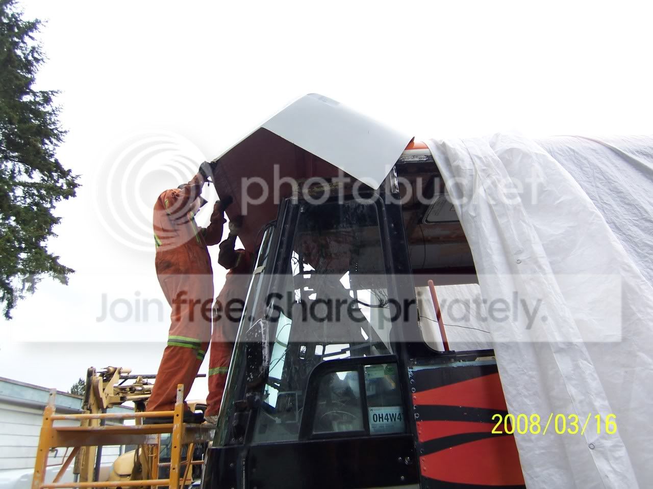

removing the old front cap
with the old front cap removed.  i still have to fabricate the new support structure due to the difference in cap shapes and heights
my son and i lifting the new front cap into place for a test fitting.
here's the cap in place before the cuts are made to the exact size
also welded in some new supports for the windows as they will be raised by 4".  couldn't get those finished as the wlder ran out of gas.  tomorrow's projects are to get those all finished and grow the balls to actually make the cuts in the new front cap to make it the exact size.

Not too late.  Its a good idea to cover every piece of glass and plastic that you don't want to replace with carboard, wood, something to stop the sparks from welding, cutting and grinding. Its hard to belive but the sparks from a grinder can melt into a glass window. The sparks can also leave a nice mess to clean up on stainless.
hargreaves
Thanks for the pump up Jack I needed it.  I never even thought about the windows. the windshields are being replaced but the drivers and door windows aren't. todays project get gas and more welding. It's raining so the caps will have to waitand I can remeasure AGAIN!!.  Gerry
