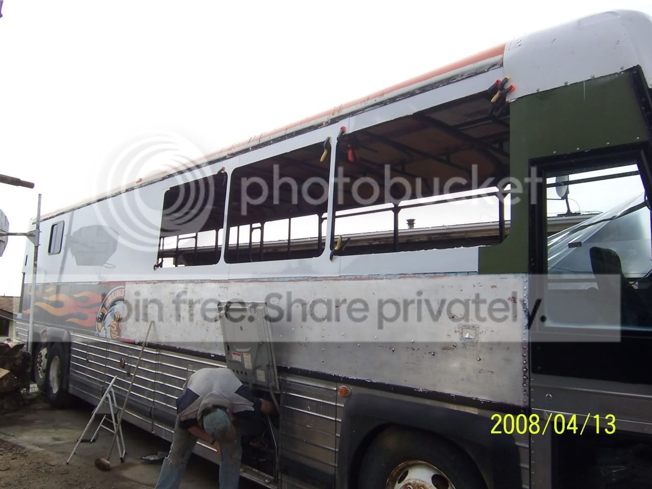

Hi Gerry: Did you add diagonals as per photo.....to carry the vertical up & down torque stress from like what Stan posted?
I don't know if you can see the light blue dashes connected from top of rear side window's roof frame to bottom of next vertical post at the bottom corner of the triangle. Second diagonal connected top of same "next vertical" post to bottom of "cradle" post at cross connection (above the engine's doors) to make a triangle.
I assumed that you are going to solid rivet the one side aluminum panel over one of non RV window hole. Otherwise add one diagonal brace or cross brace ( \ or X ) at each side.
This to control the horizontal movements from the engine's cradle vertical reactions.

Thanks Jerry I was wondering whether I should do that or not. I am going to sicaflex the side panels so I `guess I should add the diagonals

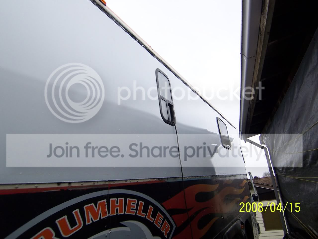

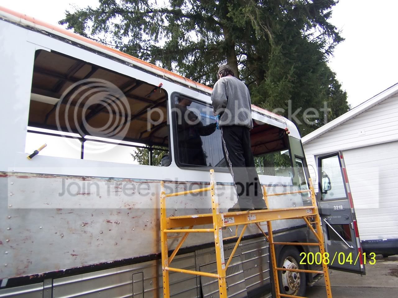

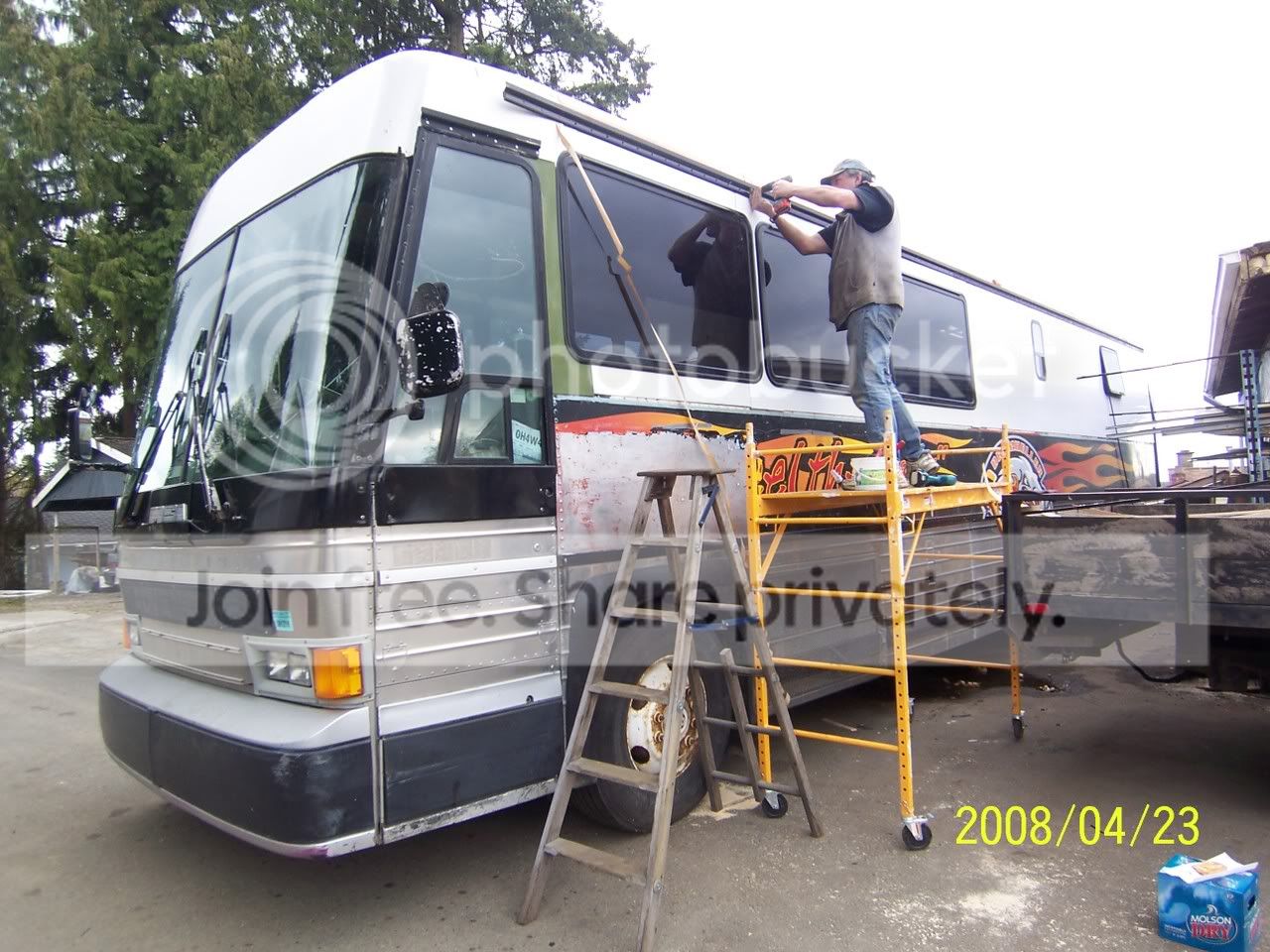

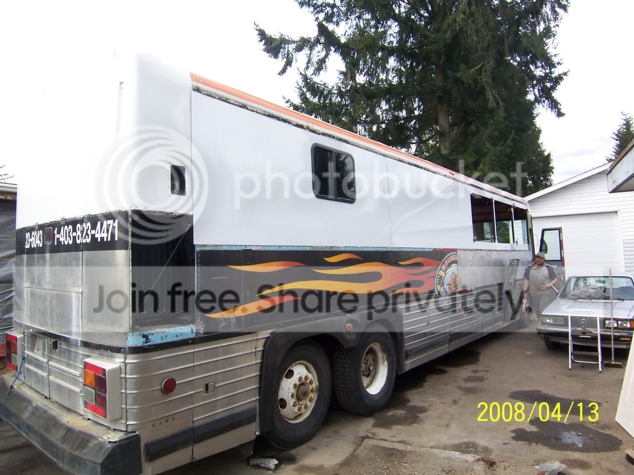

well it's been almost a month since the last update and quite a bit has been done since.  the side panels are all on and the windows are now in so the tarp has been taken off.  the heating ducts/furnace and floor have all been installed and the insulation and interior walls are now going in.  don't have any really recent pics as of now but these are the last that were taken
now as of Feb 2012 series 50 B400  . Sunshine Coast British Columbia
hargreaves
will update with some pics this week
ea187
no updates posted yet but i will testify that this thing looks 1000 times better now with some paint
