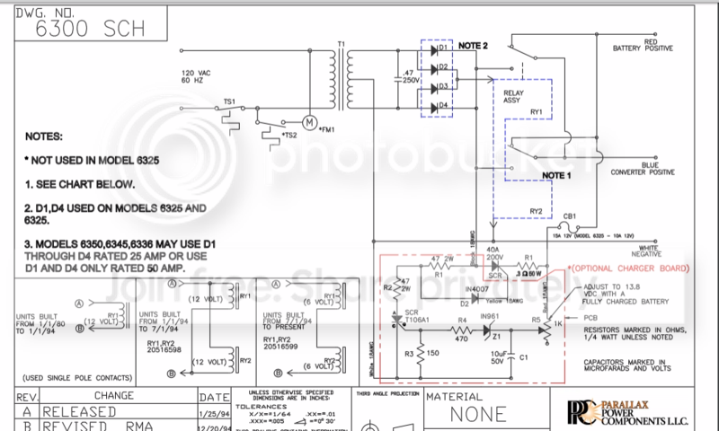

      I'm a little unsure the details you're talking about. What are the specs on the converter, Gary?  What is the voltage and type (AC or DC) going in and what's the spec of the power coming out?  What's the max amperage?

Bruce, Here is photos of the cover of my converter, I hope this will help you with your questions.
Gary
Gary
Gary LaBombard
Bruce, I hope the photos above open up bigger for you, I cannot get them to open up to larger size to view.
1) Series 6300, model 6345 with battery charger   45 amp.
2( Electrical rating input 7.8amps, 120 vac 60 HZ
3)12 VDC fuseblock, max. branch circuit fuse size 20A
4) Average charge rate 5 amps.
5) electrical rating: Max Main 30 Amps 120 vac
I am not sure if this is enough info, let me know.  Everything I have is in the photos I sent you if they expand so you can read them.  Thanks ahead of time
Gary

     Thanks for the info on the converter, Gary.  It looks like a very useful and well-made component.  I was not sure how the battery fits in the system, but I see it's attached to "Stud C".   Which components are you running off 120V - I'm guessing at least the water heater; anything else?
     I think that the discussion shows that you're doing well and things are looking good.  I second the suggestion on a "circuit finder" tool.
     Best wishes, and good luck,   BH

Gary, make it easy just use a Iota DLS charger and forget the converter, use a fuse buse bar and a ground buse bar everything connected to the batteries,then drop the extra charging lead to your starting batteries.Converters are a problem and kill batteries even the newer ones I just tossed one from the Trek and went with the above setup mentioned that has worked in Matt's Eagle for 20 years.Boats don't use converters just good chargers and a battery bank fwiw
thomasinnv
Gary that looks like an old style single stage "battery boiler" so just a word of advise, unless you plan on replacing it later with a 3 stage smart charger, be extra careful about battery maintenance. It will boil batteries.

OK you guys, thanks to all by the way.  I have been told and read about the battery charger part of a converter possibly boiling a battery etc.  My instructions on the panel says it automatically cuts out when battery is full charge but I will succum to your suggestions with one modification.
I will put a battery cut off to the (+) side going to the converter that when we are connected to shore power that the batteries do not get charged and like you suggested Cliff use a good battery charger which I also have and will use and cut out the threat of losing my batteries.
Using the converter when connected to shore power will still allow me to use my converter as a main feed to the 12v system I believe as the shore power immediately switches the converter from 110v to 12v.  When we stop to camp etc, I just have to remember to switch off the battery charging part.  I will leave instructions at unhook and hook up time to engage or disengage shut off switch. I will need the 12v side of my converter to work while on the road using the batteries. I think I got this pretty covered now, thanks so much as usual for the guidance, this is the damndest thing throwing me a loop and some of you may laugh but I don't know everything obviously.

thomasinnv
Gary you can just remove the lower section (charger) and replace it with the converter/charger of your choice, retaining the rest of the panel and fuses etc. I do it all the time on older rv's.
