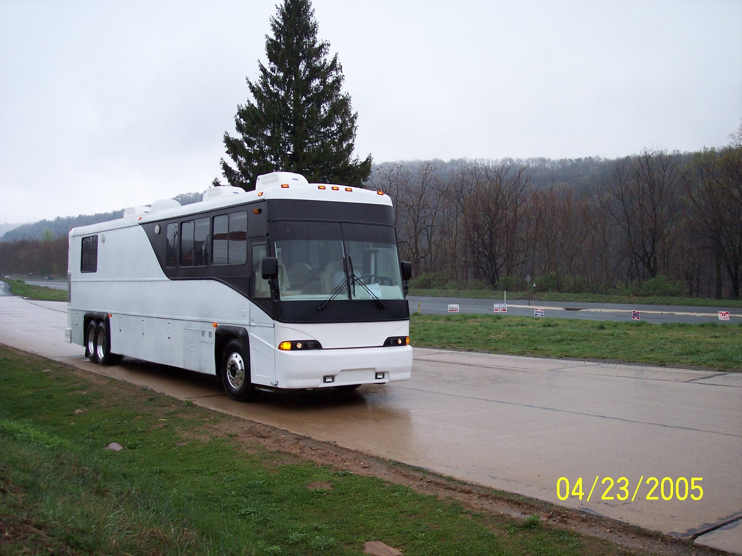

Is this a reversed tag axle rim?
Started by Scott & Heather, February 24, 2016, 05:12:51 PM
Is this an MCI with the deep dish side of the rim facing out on the tag axle?
zimmysurprise
It's offset from the drive axle- a super single?
Yep you see that I did the same on my MCI 8 and it ate tag axle tires up in a hurry but looked good
Flight102C3
What size of rim and offset would that be. Is there any chance of more pictures? Thanks for now
As Clifford said, it may look good, but eats up tires. That's because the offset of the wheel throws off the alignment of the tire. And you put undue stress on the outer wheel bearing.
When we first came out with the super singles, the wheel manufacturers simply made a 14" wide wheel that was offset to the outside by 2". Freightliner quickly found out that put undue stress on the outer wheel bearing and for those truckers that are at maximum gross weight all the time, made for wheel bearing failure. Now the only way you can get super singles is with a mid width axle that allows the super single wheel to have a zero offset. You can still convert it back to duals, it's just that the duals will be out to 102" now with the wider axle. Good Luck, TomC
The tag on the D is only inset 1 inch from the outside dual I am thinking about moving it out flush with rear dual since it has a follow along tag I don't believe tire wear would be a problem, then again it could be I am finding out the people that design the buses knew what they were doing most of the time
