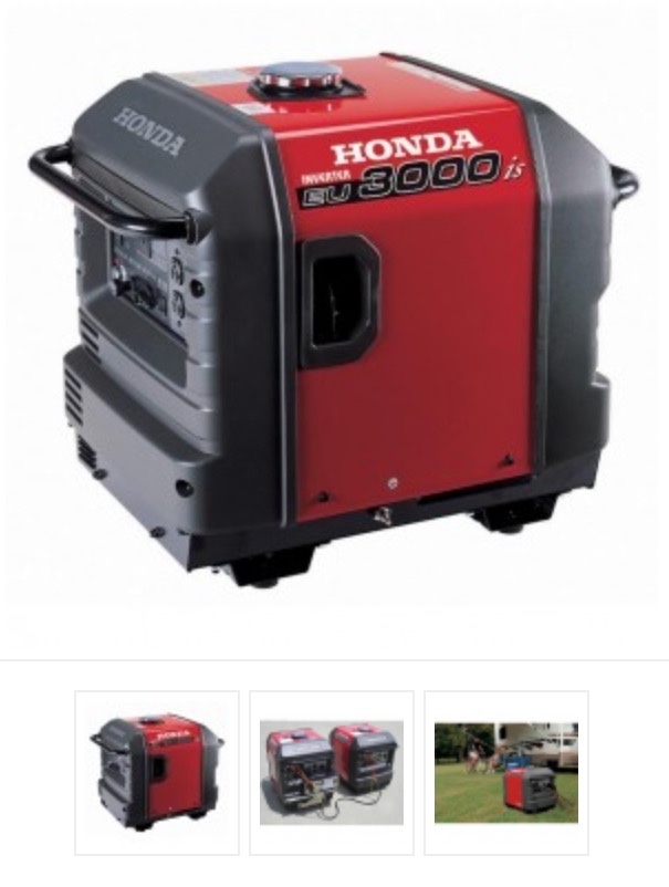

Well, after much deliberation, I purchased two of these today along with parallel cables. Don't have the time to explain fully right now, but sometime when we are more settled (January) I'll be obtaining or making a true 50aml parallel kit/receptacle for these things. For now I am happy to have a nice couple of gennies:
Quote from: Scott Bennett on November 30, 2015, 05:43:02 PM... I'll be obtaining or making a true 50aml parallel kit/receptacle for these things. ...
     Nice looking unit, Scott.  Does the true 50 amp parallel kit give you 240V or just increase the amps at 120V?
I am just curious how you balance the load on the 2 generator sets feeding 1 entrance lead,I know how it is done on the bigger diesel powered sets but not on the little Honda's you have a answer Dave M
Scott Crosby
The little gasoline Honda generators have a special plug that links them together and since they are inverters that convert DC to AC it easily matches the voltage and hertz to,double their amp and watt output on a single line ... If it was just a generator the engine rpm would cause problems with that but that's how they do it Clifford.  They are slightly different models available too as one is a slave and one is the source.  Not sure if you have to have the slave though but it's usually a slightly different price when I've looked at them.

I know what the link cable is it's a diode cable so to me there has to be something else inside each generator,I am guessing that is why they want the 2 the same model when using the cable.
I think I would split the generators into 2 different circuits 1 for ea generator and forget the link.

So yes, there is a parallel cable kit to link them together as was already mentioned. It does not give me 240v but rather 5600 watts of continuous 120v burstable to 6000 watts for 10 seconds for starting loads. These things are insanely quiet. As in, I would happily violate no gen hours in a state park if I had to because you literally cannot hear them run in Eco mode. They don't both fit quite right in my condenser bay so I'm working on mounting them on a hitch platform that locks. Hopefully will be on the road by this evening testing out the whole shebang
I looked into this once, this is what I got.  The honda gennies look for external AC on startup and synch to it, with two generators you kind of have to start one first so the second one synch's to the first one.  People have run them in parallel with other types of generators.  The cable is nothing more than a pure parallel cable, nothing else inside it, jigged up so it is safe  (you don't have a cable with two live male connectors).  They have a "companion" model 2000 watt generator that has a built in 30 amp plug so you don't need an external adaptor.  In the straight Honda world they only want you to parallel the same size generator so they load share 50-50 just naturally.  I don't know that happens if you load share a smaller generator with a larger one and the load exceeds twice the rating of the small one.  It might pop a breaker.
