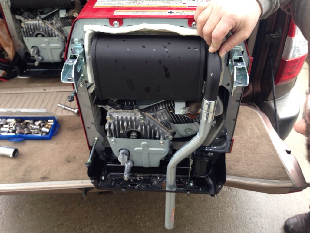

So, the day isn't going quote as planned. So far I've spent the entire day just having a custom exhaust pipe made for the twins at my uncles shop. Once this is complete, I'll start working on the slide tray. Based on some loose measuring, I think some condenser bay hacking is in ordet

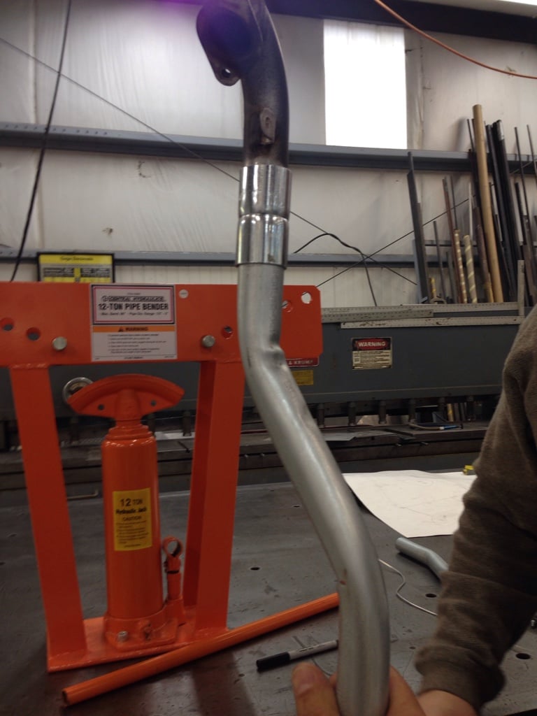

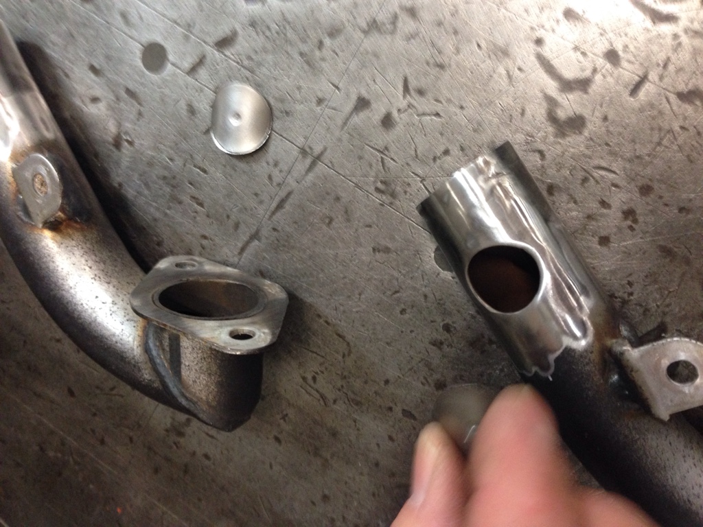

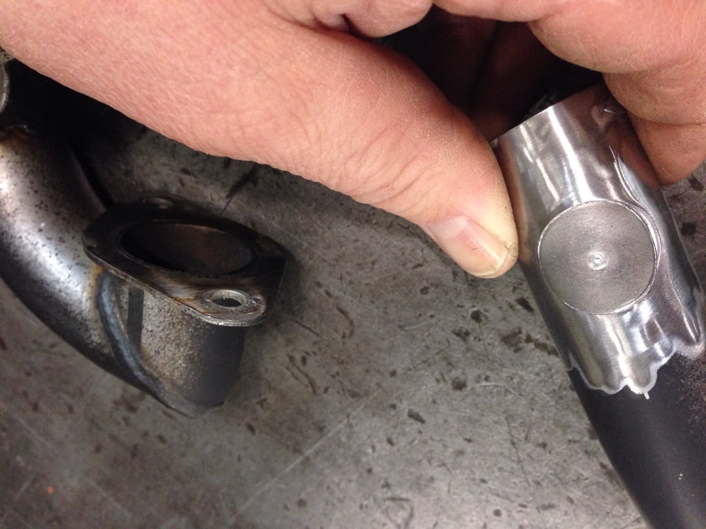

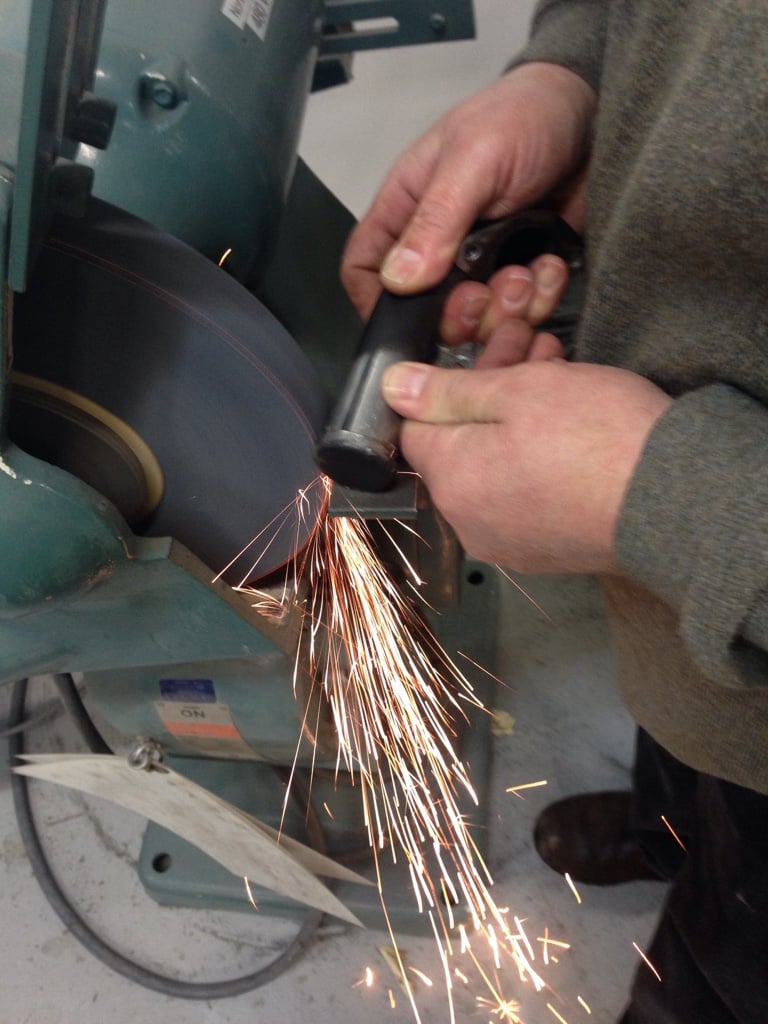

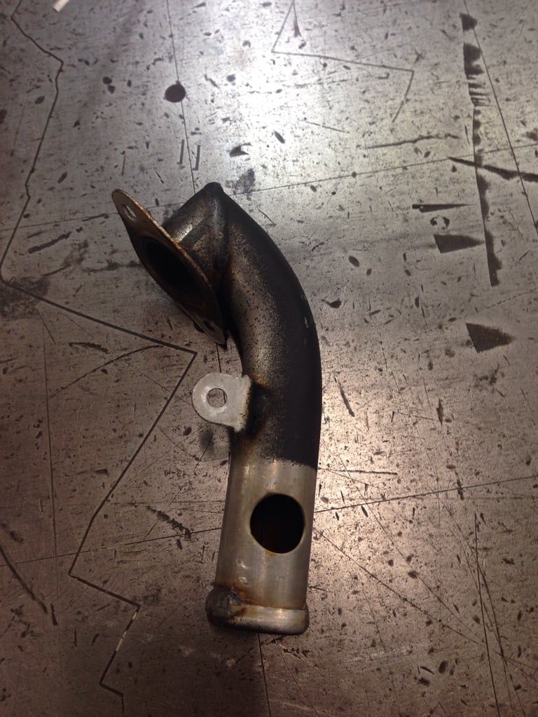

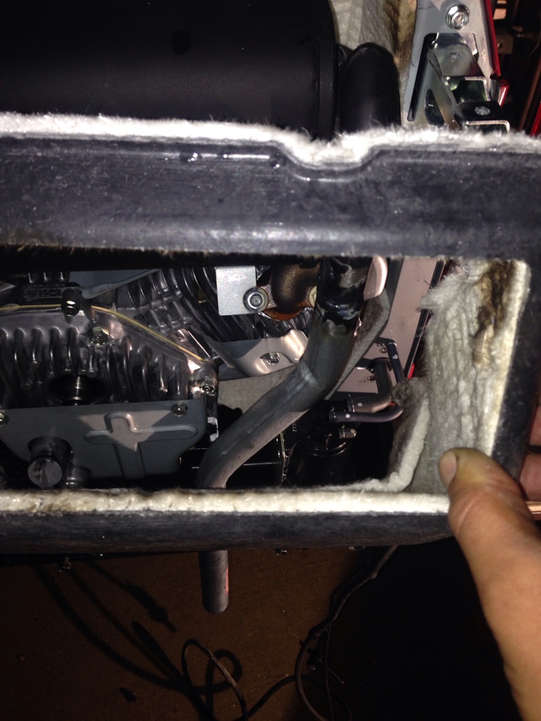

Ok so I have the exhaust done for the most part. Did some work in the rain crummy Michigan weather. Tomorrow will work on the slide tray. Here are some pics of how I did the exhaust on my twins:

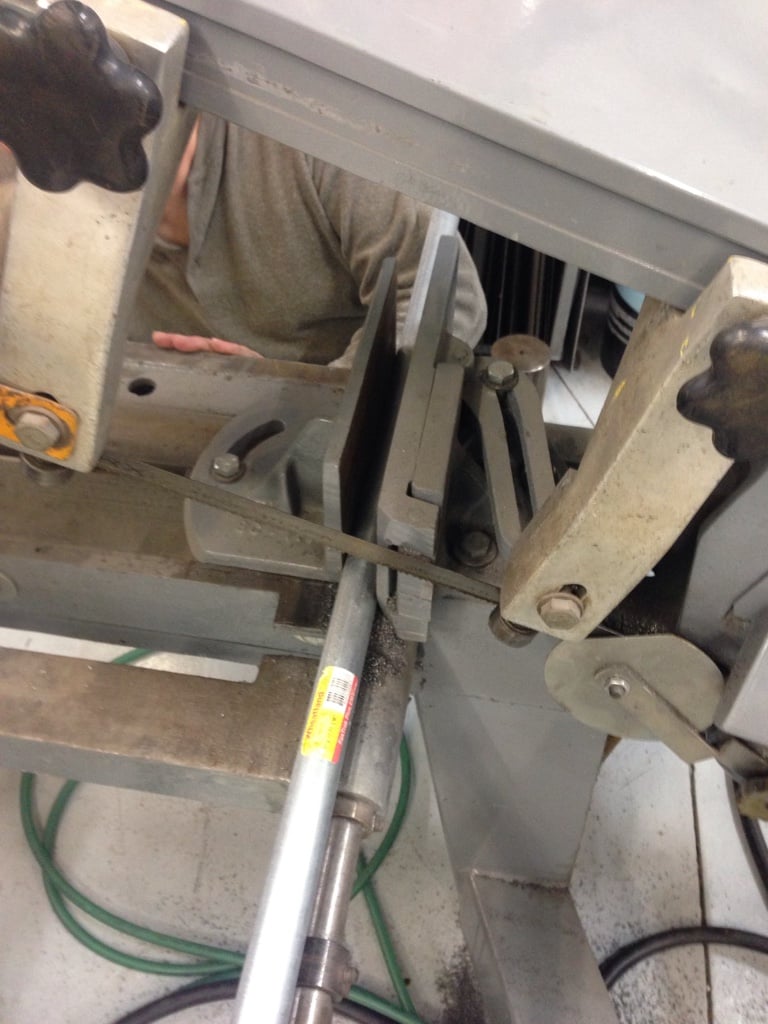

Cut galvanized 1" pipe
Removed exhaust pipe in prep for welding extension

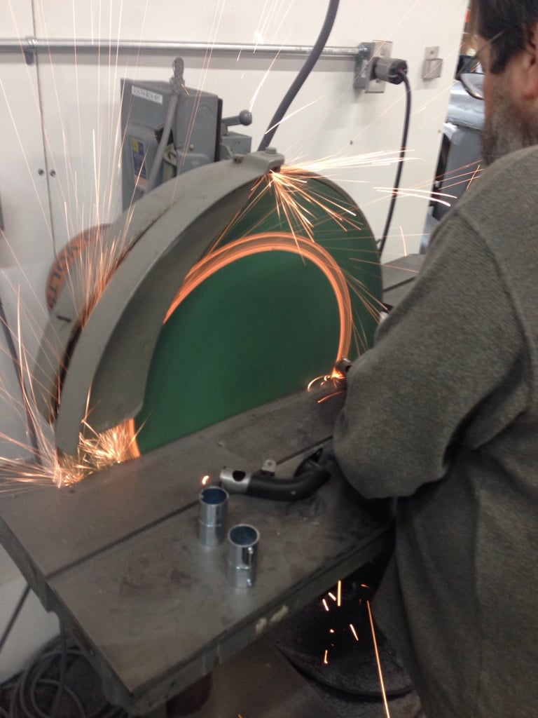

Ground off the cap that Honda tacks on to the end of the pipe
More sanding to remove burrs etc

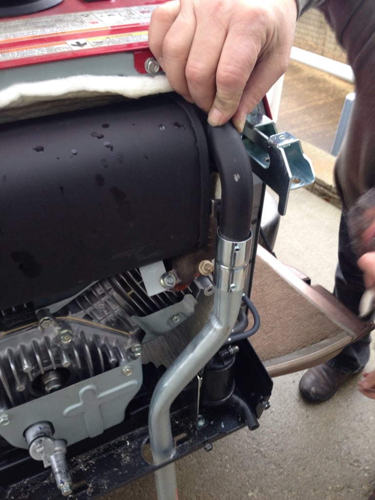

Bent the pipe into an offset
Test fitting exhaust extension before welding
Test fitting small patch we made for hole in Honda OEM exhaust pipe

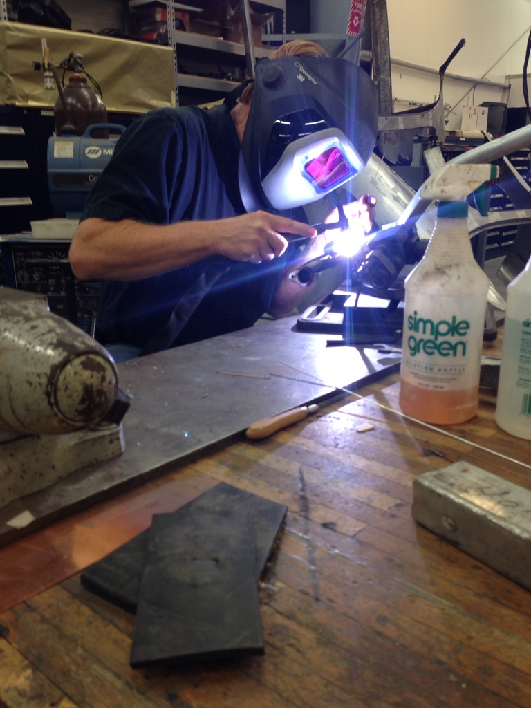

My uncle tig welding everything together
Installed with insulation back in
Someone on another forum built one of these (or like it) into a conversion, and mentioned that removing the stock muffler removed a major point source of heat, and that makes a lot of sense.  It would be neat to try that, with a remote muffler and a wrapped or coated exhaust pipe.
oltrunt
I'm sure others have relocated mufflers from their genny boxes as did I.  I also removed the computer module from the genny box which sort of made the whole genny a "plug and play" affair.  I used a small constant run pusher fan and a small, temp controlled puller fan for cooling.  As a safe guard I added two, 190 degree thermostatic kill switches on the oil sump--they have yet to come into play.  Jack
