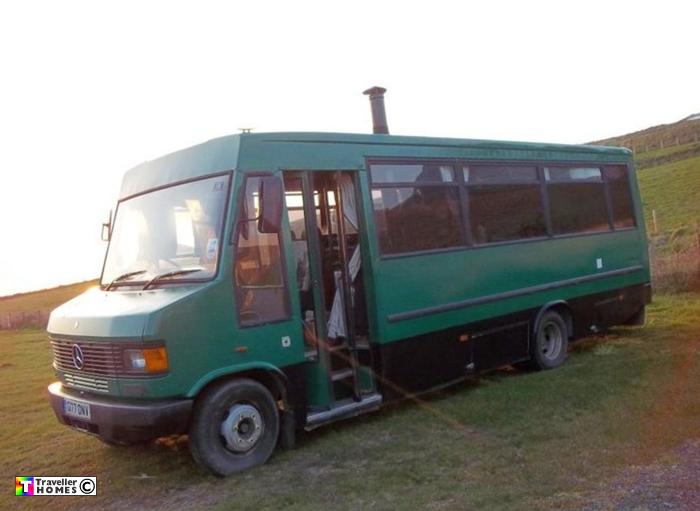

Quote from: Ed Hackenbruch on August 16, 2013, 06:24:06 AM
...some folks in Canada just bought a 5A and she wants to put in a small European wood stove.  ;D
If you're a 'Traveller' (British term for modern-day gypsy types), your vehicle isn't complete if it doesn't have a wood burning stove chimney sticking through the roof!
