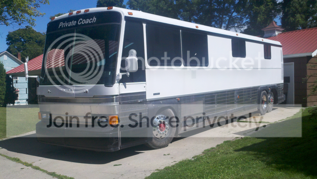

You'll find this to be a huge topic, with tons of ideas and opinions.
I just recently completed this project on my 102 A3 and it turned out so well, that it looks factory.
If I had to do it again, I would do it the same way again.
I bought 6061 Aluminum (I think that's the right number) .80 thickness.  I was careful to buy it exactly the size needed from the supplier.
First I welded in some additional cross bracing and framed in for new windows.  Then primed and painted everything that was steel.   I protected the steel from the aluminum with butyl tape, then used Silaprene Sealant everywhere anything overlapped or touched anything.
Contact Byler Rivets, they have the Silaprene Sealant, and can advise you on the rivets.  I also bought some drill bits from them, that was the best thing I ever did.  A good jobber bit is worth it's weight in gold.
http://bylerrivet.com/
I heated the aluminum from the inside with a roof tar or weed torch.  Very easy to do.  Except the Silaprene Sealant can burn, so I learned just how much heat to use.  This helped stretch the aluminum.
Then I just went back with a 4" grinder with a very thin wheel and cut out the windows.  Turned out very nice.
