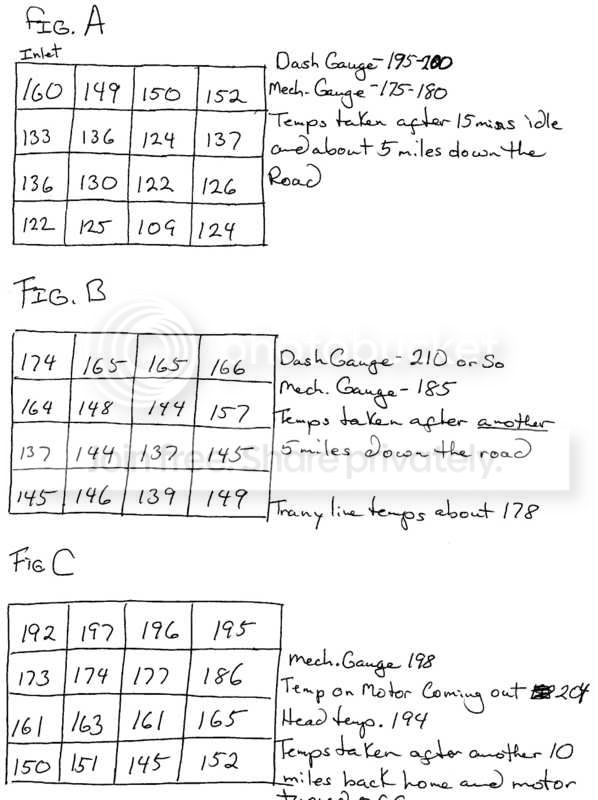

Hey Guys,
  I just took my baby out for a short jaunt to get some info on the radiator/overheating issue. Here is what i came up with using a buddies infrared gun.
  Looking at the images, you are looking at the outside of the radiator where I took the readings. I broke it down into 16 sections.  Do these look like legit readings or do you think I have a radiator issue?
The bottom line says the motor was turned off.
Also, when I was sitting at the second stop, as I was doing my thing for awhile I went back and the rad. temps started to even out - higher became lower and lower became higher.
I'm probably going to have it cleaned out anyway, but I'd really like you guys opinions. (we'll try to stay off the gun topic for you Teke. Just to reiterate, it was an infrared gun.   ;D)

Second, I think they are a tad high, but not by too much.  the issue, I think, is the temp of that you had after only 20 miles being that high,
what was the air temp outside?
Also of concern is the 204 coming out of the engine....
I think the cleaning will fix you up.

Wow. Are those suckers HEAVY!!!  Man!!
I got'er out.  :) The radiator guy said - and I quote- "Time is money", so i figured while I got it out I may as well strip it apart. Wasn't too bad, at least the bottom anyway. It's getting late so I'm saving the top for tomorrow.  ;)
But here is what I found....
  - No antifreeze. Ok, well, m-a-y-b-e a quart. The gauge didn't even register.
  -The bottom tank had about 3/16" of sludge/rust in it.
I decided to see if I could tell if I had any blockages with a 1/16" stainless steel filler rod and altho I have only gotten thru about 1/4 of them I haven't hit anything solid yet. Is that how they "rod them out" or do they do something else also.
Reason i ask, I may not take it in if I don't find anything in there. I may just run a pressure tip on my garden hose and hose it out. Whataya think?? I'm even thinking about not taking off the top tank. I'm not sure why I should. Any suggestions??
Also, how would I set up to rinse out the rest of the system? Is there someplace to run a hose in to clean it out? I'd like to go up thru the heater also.
What sort of antifreeze would you guys recommend? I guess it should take about 15 gallons. Dallas said the system holds 29 gallons. (ouch!)
Oh, and where is the thermostat hiding?  ;D I'm thinking about replacing that while I'm at it. But then, we were taught in the NAVY, "if it ain't broke, don't fix it"!   ;D ;D ;D

mine was about the same. lots of sludge in the bottom. I took mine in and they flow tested it and flushed it. said it flowed to spec. they also soaked it and cleaned the fins on the outside. there was probably more crap in the fins than there was inside it. when I took it in I had already washed it out and taken out tons of dirt from the fins but you could not see light thru it. when I got it back it was lighter and you could see light through it. they only charged me $150 to clean it and test it. I didnt have any heat issues but I had to take it out to fix other stuff so I figured it was money well spent. BTW I used a fork lift to take mine out. they are lighter that way.

What a mess! I take back my last post. The TOP of the core (tank) was loaded!! Definitely doing some blockage.
I told my parts guy what I need in antifreeze and he says "no problem". He says Wix has the precharged additive. I'm going to get that i guess. And altho i have never used distilled water......eh, what the hell. Why not.
I rinsed the whole system - took out plugs, unscrewed petcocks and opened up hoses. Man, what a bunch of nasty stuff. It took a few rinsings from both ends but she seems pretty clean now.
