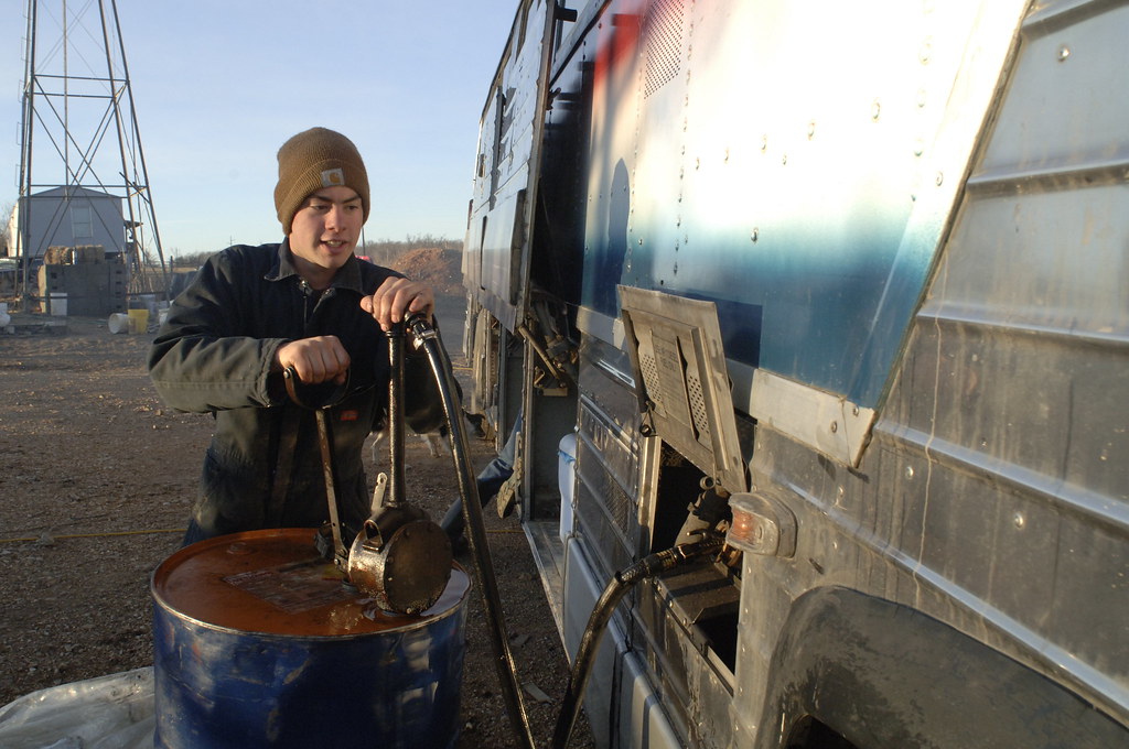

Blake
Me pumping biodiesel int the bus on our trip!!!
