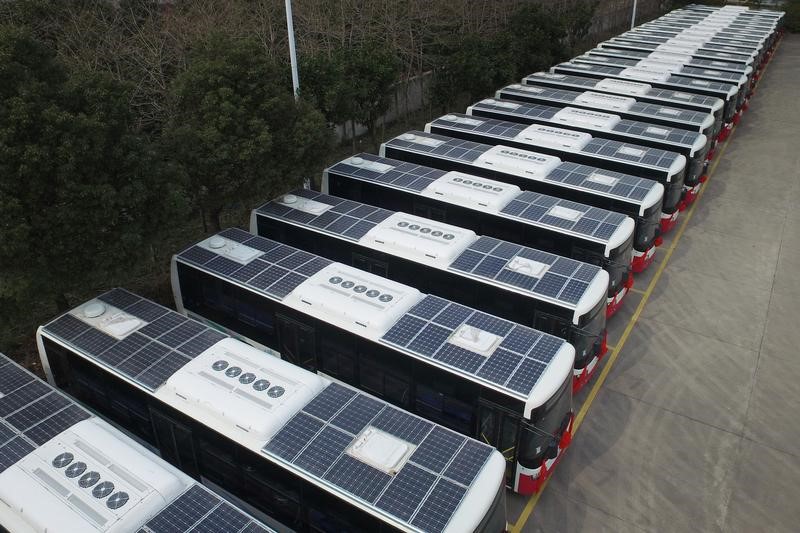

I'm amazed nobody has covered an electric care in solar panels so that over a few days or weeks it could recharge itself.
Sent from my iPad using Tapatalk
Carpenter 3800 1994 on a Navistar 1994 chassis with a DT466 and alinson transmission.
Quote from: Zephod on June 20, 2017, 01:50:36 PM
If you Google you will find lots of examples of that, plus buses as below.
Stop-start transit-type buses on regular routes are the perfect candidate for being 100% electric because they can make full use of both regenerative braking and, with the necessary infrastructure, inductive charging at every bus stop. There is at least one such system already in operation in the UK where I believe the buses also run driverless in dedicated lanes for some parts of their journey. My own city has quite a big fleet of electric buses as well, although despite seeing them every day I'm not sure quite how 'electric' they really are (I've always assumed they were actually hybrids like the new Routemasters etc)
At most you could fit only a few hundred watts of PV on a car (and it would look mighty weird).   If you could shoehorn 370 watts of panels on, that's only half a horsepower, and that's ignoring efficiency losses and less-than-sunny days.   A fit cyclist can develop more than that.   My garbage disposer is more powerful than that.   Half a horsepower is not even enough to power the car's A/C.   Maybe you could run the windshield wipers on that much power, but if it were raining you wouldn't be producing any PV power anyway.
If it takes days or weeks to recharge an electric car from solar, then that kinda makes the car completely bloody useless for all the time it's sitting there quietly absorbing its fill of electrons.   Perhaps one could temporarily repurpose it as a chicken coop or a dog kennel or something else, but as a car it would be a non-starter, literally.
I've had folk look at the two thousand watts of panels on the roof of my bus and they ask me "So now you can power the bus just from solar?"   They seem genuinely surprised when I tell them that it doesn't quite work that way.   With all the power I have, it's still only the equivalent of less than three horsepower.   My MT42 starter motor is several times more powerful than that.

Zephod
Quote from: Iceni John on June 20, 2017, 04:06:26 PM
I think you're a little harsh on solar power. Even a little solar panel adds some charge. Even if it adds only a couple of miles to the Daily range, it's still worth doing.
