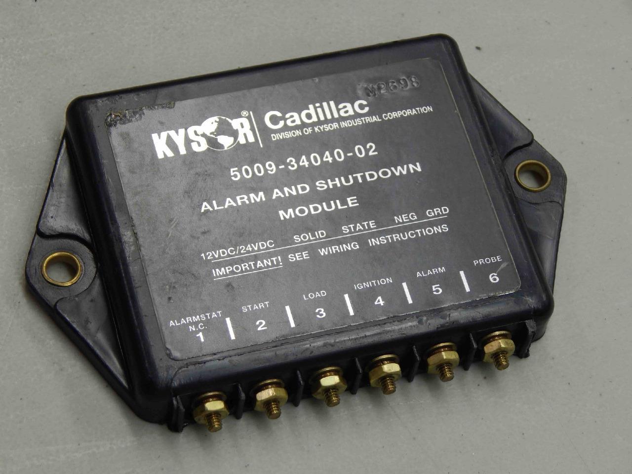

Newell used the Kysor system on the mechanical 8v92,you should be able to download the manual off the net if not I can send mine to you and you can copy it.
It is a fairly simple system even for me.Kysor has changed owners and names several times over the years but they are still the same.Only other system I saw Blades use was a Murphy if so I cannot help you

THANKS Luvrbus,
Is this it --  http://www.rossairworks.com/images/stories/pdf/ts-guide-medallion-905.pdf
BTW, Any suggestions where I might find the module ?
kyle4501
Nothing like that in the engine compartment.
I'll have to look under the dash.
Is there a system without a control module?
Quote from: kyle4501 on February 26, 2017, 01:28:06 PM
Yes
kyle4501
Quote from: luvrbus on February 26, 2017, 01:32:26 PM
Yes
I haven't found that yet - either too old for the internet or I'm not using the right key words. . .
Quote from: kyle4501 on February 26, 2017, 02:29:29 PM
I haven't found that yet - either too old for the internet or I'm not using the right keywords. . .
What year, what motor?
Kysor Cadillac was the major player in the mid 80's
Murphy used humongous sensors....

The only box I could find is a Super ISSPROLARM. It is under the dash and is a low coolant level alarm.
I'm beginning to think it may be easier to put in a simple marine engine warning buzzer kit - a buzzer & light should catch my attention. . . .
