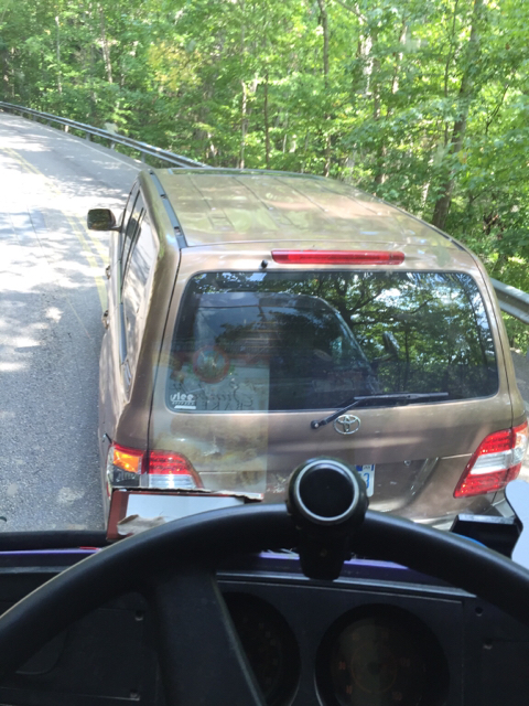

I wasn't going to post here about this but Cliff started the discussion on my Facebook page so I thought I'd ask around here. Yesterday we were driving the coach up the very steep grade of the Park Vista Doubletree Hilton here in Gatlinburg TN. She couldn't make it up so we unhooked the 7,000 on land cruiser. She still couldn't go at full throttle she was just sitting there. So I backed down the hill gave it a small amount of a running start and made it to the last steep curve near the top. She pooped out and actually started rolling backwards under full throttle. This caused the tow hitch to jam into the pavement behind me on the curve. I was now fully stuck. Couldn't go backward and certainly couldn't go forward. I blocked traffic for an hour while figuring out what to do. A tow truck wouldn't even be able to get past me to tow me up, I had no way of reversing since the pavement behind me on the curve rose up and it would just keep wedging the hitch into the pavement. So I drove the Land Cruiser to the front of the bus, chained it to the tow loops on the front of the coach and to my frame tow points on the Cruiser. I have triple lockers so I put the Cruiser transfer case into Low gear, actuated all diff locks, and had my wife tow the bus up the hill while I drove the coach giving it throttle behind her all the way up. She spun all four tires for a moment until we got the coach unstuck from the pavement but after that we walked up that hill like it wasn't there.
So here's the question:
My coach was rated at 400hp and we did give it a little bump recently via computer and someone who knows their stuff. But it should have more low end. My 6v92 bus got up that same grade last year. Is the gearing in the rear end of a 102C3 8v92 different than a 9 with a 6v92? Or do I need to turn up the fuel down low in the RPM range or something? Here's a photo of heather towing me:
