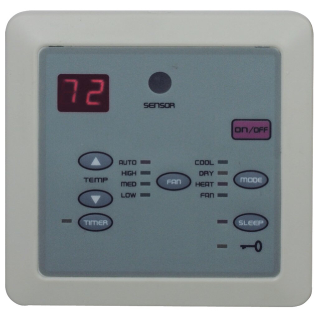

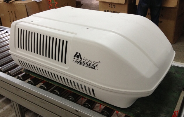

So we have our Air Command installed and running now. I have a second unit in the box ready for install as well. These are 15,000 BTU heat pump units and I purchased their digital proprietary wall thermostats too. Actually I purchased one and Atwood sent me one free of charge as well (long story). So we have two thermostats controlling two different roof units. Initial impression is excellent. The wall thermostat lets you control between heat mode (which will bake you out if it's in the 40's or 50's) cool mode, dehumidify mode or fan only mode. Dehumidify will just kick the compressor on and off at 6 minute intervals. It does this really well. Cooling is very effective keeping the coach comfy so far this summer with just one unit installed and no windshield curtain and temps hovering 95 here in Michigan. Two will freeze us out I have no doubt. We are spray foam insulated and floor as well (2"). We also bought the wireless remotes so we can turn them on or off from bed. Nice little touch. Here's the biggest deal of all: these units are QUIET. Seriously, amazingly quiet. I can hardly hear it right now and it's just bowling straight down. When it's ducted it will be so quiet it will not disturb conversation or peace at all. They use something they call "v flow" technology which I think is just the shape of the styrofoam air duct. Anyway, I am very impressed so far. These units are new and have been on back order so if you order one be patient. I paid $588 for the unit plus shipping. This is the rooftop unit only. No interior panel or tstat. Purchased those separately.

I hope the heat pump function works better than the Dometic units I had back in the nineties. I had three heat pump combo units from Camping World, two failed within a few months. I got free replacements under guarantee, and then one of the replacements failed quickly. Camping World had a satisfaction guarantee, so I returned all three (at their expense) and got a full refund. I bought three Penquins with heat strips, and they have worked ever since without problems. The heat pumps (then) would not work at all when it got to 40 degrees. It looks like the Atwood units are tall and are going to reduce roof clearance a bit, I hope they are dependable for you.

They aren't any taller than a Coleman Mach unit. But I do need to measure my total coach height now. I have a 102C3 with an 8" roof raise, 24.5"  11r tires and Atwood roof airs. I hope I'm not pushing height limitations.
thomasinnv
Scott you might want to measure your height. Stock height on the D is 11'10". With 13.5 inches of my coleman mach I am sitting at 12'11.5" i beleive your C is the same height, so with your 8" raise you may be over 13'6.
