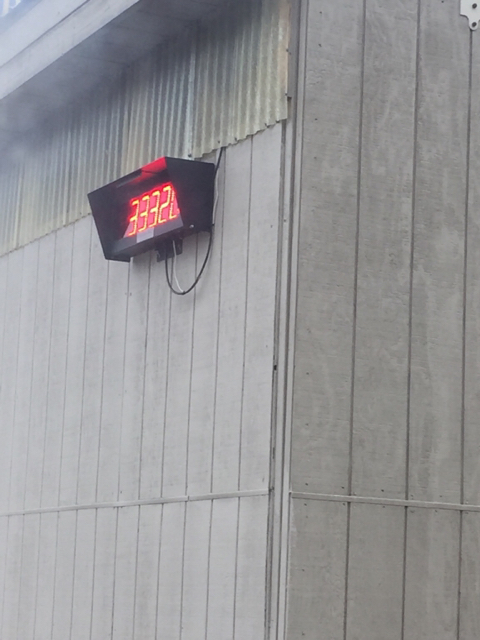

9 grand for a shower? People do realize a shower is a waterproof place to stand and wash grime off your body.....not feeling the whole $9 grand thing. Yikes. I do like to keep weight issues in mind   Because it can add up fast. Our MCI-9 completed weighs in at 33,320 lbs with a full 100 gallon freshwater tank and 90 gallons of fuel. 3/4" wood floor and 3/4" knotty pine walls. Full wood cabinets in kitchen and a lot of stuff. That's actually pretty light these days with some bus conversions tipping the scales in the 50,000 lb range. Here's my latest weigh in about a week ago:
