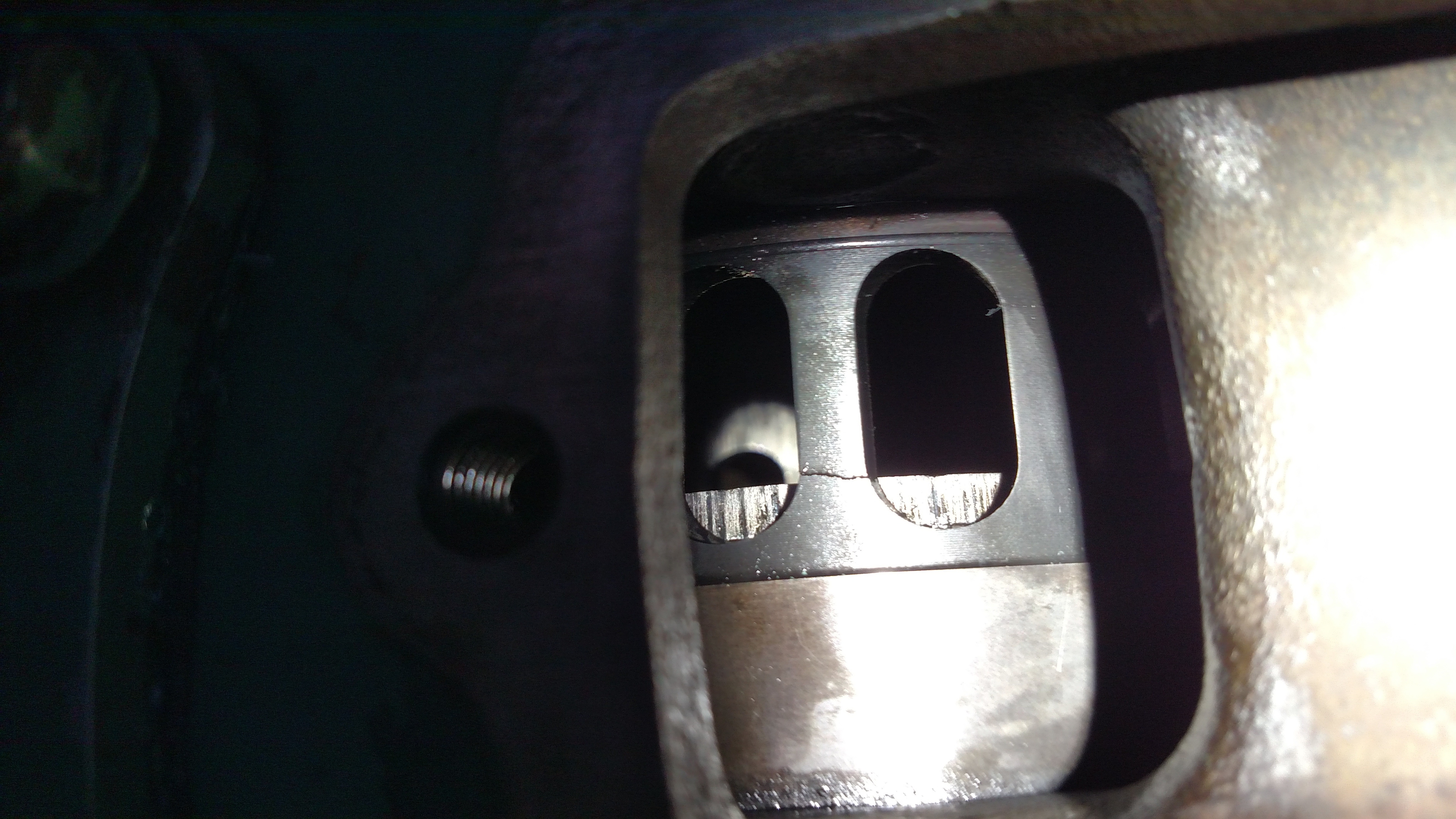

Easy band-aid repair for the bus but that engine had been abused so who knows how long before it does it again.   Here is a better pic from Kevin   I'll change it if that's what she decides to do. It's going to cost her around 2k if I do it and 1k of that is airfare.  Pretty sure that's like a 5k repair most other places.  She said it didn't get hot when it happened and they didn't lug it up any hills so I'd like to know how it happened.  Is the block damaged or misshapen from the overheat before? That piston looks knarly too. Was it oil starved? More questions than answers but if she wants a new kit in it I'll do it.  If she looses her toad and drives it up the mountains right I think it will hold out unless something else reveals its ugly head when or if we tear into it.

That piston does look pretty bad for sure!

It's been hot like real hot,it's probably has a 1 piece piston they are bad about breaking liners after being run hot.You have another 7 pistons and liners just waiting for a time and place

I you decide to do it, I have the tools to check the block.
I'll be curious to see how the liner comes out. It may be a loose fit.
The other ports were clean and dry.

    WHOAH!!!  Hungry aluminum rodents couldn't chew one up that bad!

Yeah the piston looks like a ginsu knife serrated edge.

Lol. You guys crack me up. That piston looks terrible. Kinda looks like a caveman made it out of stone tools lol

Wow, I'm no expert, but with so much missing aluminum on that piston, I sure would be surprised if that motor makes it more than an hour at freeway speeds. If Cat lady needs the bus in SD, perhaps having it towed there would be better progress than spending 3K and then an hour down the road do it all again? So close, yet so far away. I personally would be skeptical driving that into the desert.... maybe if she makes it to Cajon pass she can coast into the valley... every mile will count I suspect.
