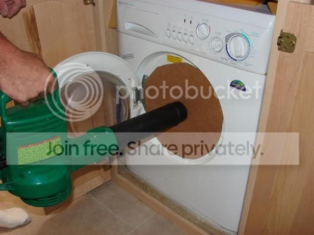

Here are the steps I follow monthly to keep my Splendide vents clean.  Your mileage may vary.
1.   Do not put any clothes in the washer
2.   Do not put any Laundry Detergent in the washer
3.   Put 1 cup Vinegar in far left tray
4.   Set the dial to cycle #11 (Silk)
5.   Turn the machine ON
6.   Set the WASH TEMP to Hot
7.   Set the DRY TIME to OFF so it will not enter the Dry cycle
8.   Set a timer to 4.5 Minutes
9.   Push the Start button
10.   When the water stops entering the unit push and hold the Start button until all lights comes on, then release the button.
11.   If the water is at least half way up the glass, go to Step 27
12.   If the water is not at least half way up the glass, read on...
13.   In my case it only came up to the bottom of the circular glass on the inside of the door.
14.   Rotate the Cycle dial one full turn to cycle #11 (Silk)
15.   Set a timer to 3.0 Minutes
16.   Hit the Start button.
17.   When the water stop entering the unit push and hold the Start button until all lights comes on, then release the button.
18.   This time the water came up almost to the bottom of the horizontal bevel in the glass.
19.   If the water is at least half way up the glass, go to Step 27
20.   If the water is still not at least half way up the glass, read on...
21.   In my case it only came up to the bevel on the glass, which is less than half full still.
22.   Rotate the Cycle dial one full turn to cycle #11 (Silk) (Again)
23.   Set a timer to 3.0 Minutes
24.   Hit the Start button.
25.   When the water stops entering the unit push and hold the Start button until all lights comes on, then release the button.
26.   By now, the water level should be at about 5/8 full which is over half-way as instructed.
27.   Move the cycle dial to cycle #12 (Wool)
28.   Press the Extra Rinse button
29.   Press the Start button once (do not hold) and let it run through that complete cycle.  Even more water will enter the machine bring it up to almost 5/8 full before the water started agitating.
30.   This cycle will run for 59 minutes.
31.   Run thru this entire cycle again until you have run it 3 times completely.
1999 Prevost H3-45
Darkspeed
100. connect leaf blower to vent hose with duct tape...
Wow that is quite the process you have there!
