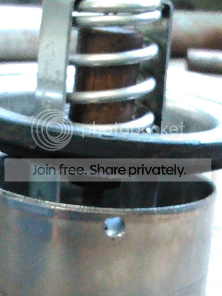

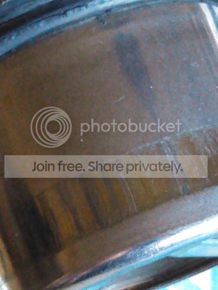

Hello All.  I discovered that I had little or no cooling going on in the driver's side radiator while having obvious cooling taking place on the right side. I removed the thermostat (180 degree F) from the driver's side and tested it's opening closing point and measured initial opening at 164 degrees F with complete opening at 180 degrees F respectively. Closing temps were the reverse. I saw some scoring on the moving part of the thermostat where it slides up and down in a stainless steel sleeve between the inlet and outlet ports. The scoring is heavier on one side. Also, when the thermostat is in the open position it looks like the opening motion is not parallel with the sides of the housing leaving a "tipped hat" appearance to the open thermostat. Despite the fact that the thermostat responds as it should to heat, I wonder if the off center opening is causing the thermostat body to hang up and not open? Any ideas? Thanks, Jack

This pic shows the score marks.
This pic shows the "tipped hat".
Those are a partial blocking T stats not a full blocking T stat most all of those tip a little.The seal in the housing will cause air bubbles when bad and cause poor circulation  did you check the seals,the T stats and seals are cheap enough change both sides and be done with it
oltrunt
Thanks luvrbus.  The seal between the thermostat and the housing was fine until I gouged it out to free the t-stat.  I can see how a bit of coolant could get by the ring (where the scratches are) and through the small hole you can see in the third pic.  Is that what you mean by partial blocking or does the water bypass somewhere else?  If so, I may still have a blocked radiator.  Thanks, Jack
Jack, as you probably know they work a little different than most T stats the bottom slides to close and open the seal in the housing will get old and brittle and it won't slide but I can see the marks on the housing where yours did slide at one time
Change the bottom seals and I think you will be fine as far as the T stats go, fwiw people waste a lot of money changing those when a 4 dollar was the problem to begin with

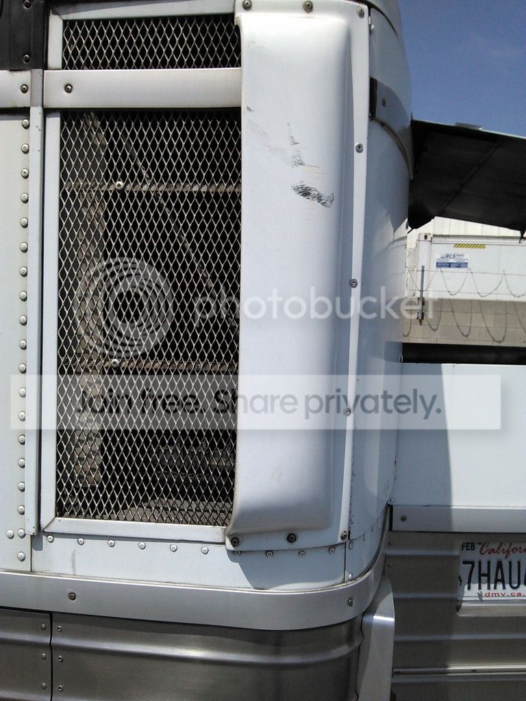

Hello All. I took the plunge and removed the driver's side radiator on my MCI9. It took me 4 hours to get the thing out as I've never done one before. Much to my delight, every fastener came out without any trouble. Even the shutters were cooperative. Once out I looked through the fill port and the drain port I saw no sign whatsoever of blocked tubes. I filled the radiator with water and then releases the bottom port. The water flowed out as if I had dumped a bucket.
While the dry weather where the bus was used can be credited with the ease of disassembly of the radiator, it can also be blamed for the fine grit that had all but blocked the radiator fins. They were so clogged that I couldn't see light through the core. Fortunately, a good rinsing with a hose was all that was needed to clean the core and now light flows through.
The County had installed fiberglass air scoops at the rear of the radiator. I suspect these scoops did more towards stopping up the core than they did to increase air flow as the plugging was the worst behind the scoop. I guess I'll put the thing back together without the scoops but with new thermostats and seals after I use test strips on the antifreeze. I'll report on the results. Jack

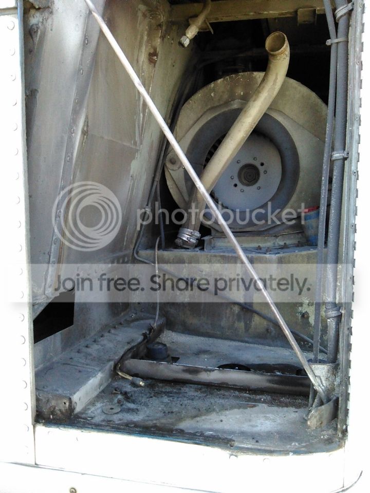

This is a pic of the shroud.
This the cavity in which the radiator lives--no rust or corrosion, I'm lucky.
