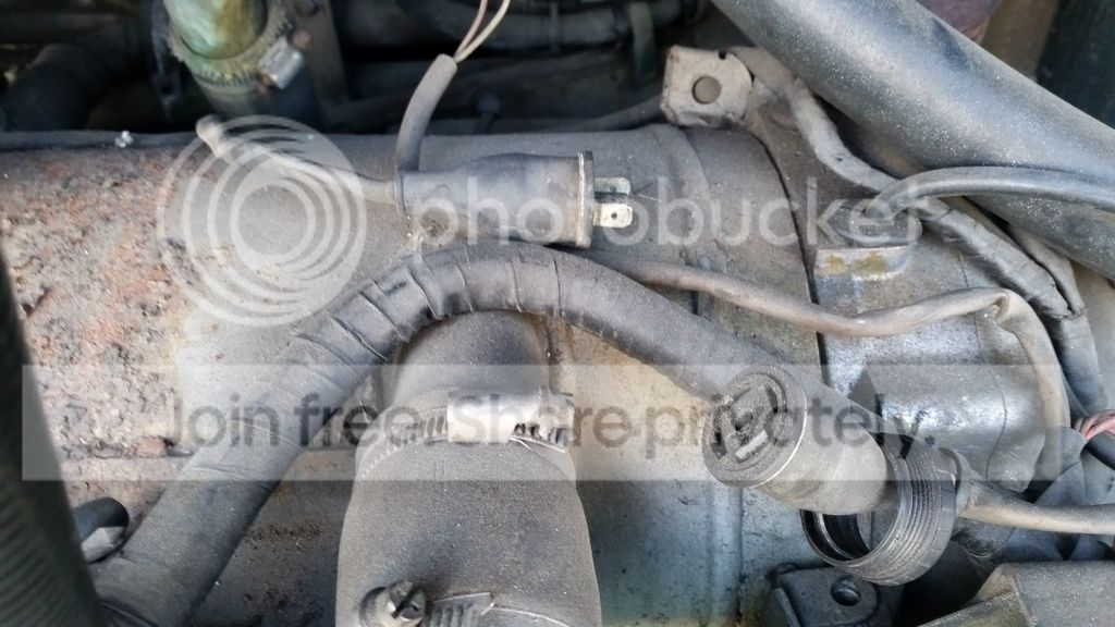

Ok so this is odd. We have power back at the pump. The webasto is bypassed and always has been during my ownership of this vehicle. The pump, however, is disconnected. It seems to pump when plugged in (albeit it's not the smoothest running thing in the world).
Engine is warming up now while we eat breakfast. We'll see if we get heat up front with the pump plugged in. If that works..why on earth did I have it before? This plug didn't unscrew itself.   ???

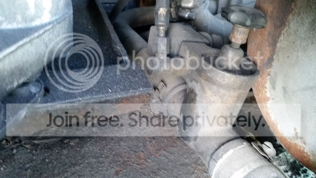

Also what is this valve? It's just left of the webasto.
I have no knowledge of setras so take this with a grain or two, but that valve looks like a gate valve to shut off the coolant flow to your coach/driver heater cores. We have two on our MCI. Since our over the road heater cores were both removed (which I throughly regret) those gate valves were closed to prevent coolant loss at the cut copped piping that formerly went to the heater cores.

No on closer view of the above photo the valve with the knob appears to be some sort of variation of the valve I was describing to you.  (and appears to be located in the right spot too!)
I've never seen one with the gate vale knob before. But it appears the little black box with the wires on it is the same black box I'm used to on the valves I was describing to you.

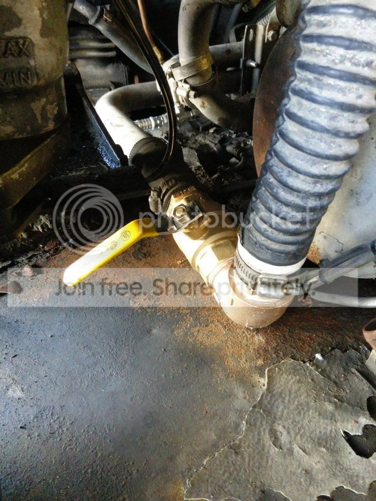

BK was spot on, that valve was toast. Well, the solenoid that controlled its actuation was toast. I had no continuity between the terminals.
I just wanted to close out this thread with an actual answer/solution, for anyone who might stumble upon it in the future. Nothing is more annoying than finding a thread with the same problem you're encountering, but no documented solution. So here's the solution:
One manual ball valve, and we have heat again (when I open it). Woohoo! Without having any good rubber hoses long enough to pinch nearby, I just worked as quickly as I could in swapping the valves. I lost almost exactly one gallon of coolant in the process, but I didn't have to drain the system and I see no evidence of air bubbles being introduced. Win-win.
