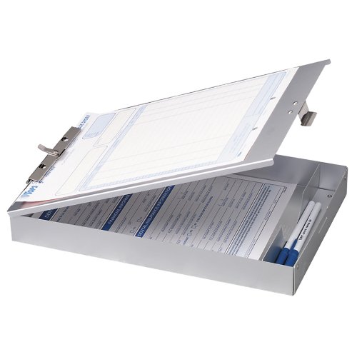

I cut a hole in the side of our MCI 9 and stuck stainless mesh over it so I could pull it off and slap a clipboard over the intake rubber grommet.

in this runaway scenario, a clip board could possibly/likely be ingested also...that's why airhorn flappers were steel :)

Aha then! My clipboard shalt be made of steel!

the aluminium ones with the folding cover work very well too...
and will look very
professional doing
either job :)
i prefer this one... http://www.amazon.com/Saunders-10519-Recycled-Aluminum-Snapak/dp/B0007UO4OQ/ref=sr_1_20?s=office-products&ie=UTF8&qid=1437326064&sr=1-20&keywords=Aluminum++Clipboard
PS cut and pasted for your conveniance and --- --- ----'s irritation... ;D
