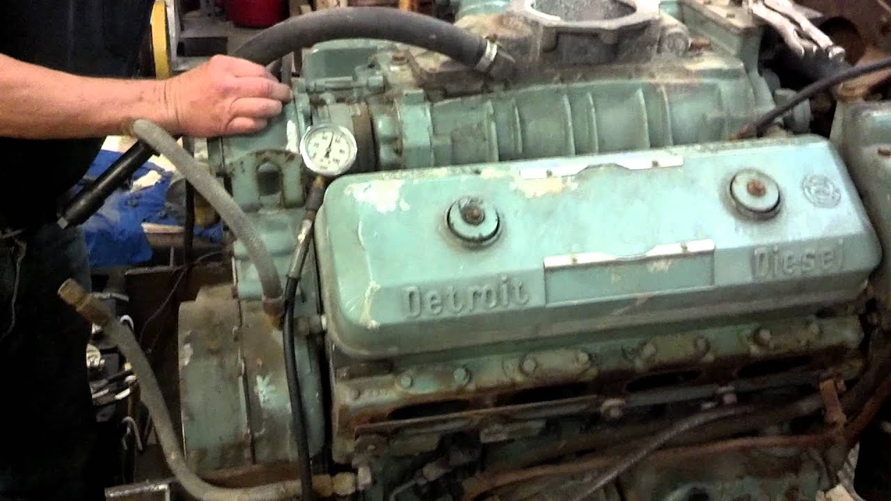

sorry about the big picture...but i was hoping to make it clearer things you may not be able to see.
there are only a few places oil can leak....
the small tube
the large hose
the blower end covers
the governor area
govenor rack control rods front to each head small short hoses
the valve covers
the end plate between the block and gear case
a gallon of oil makes a huge mess. do you have a huge mess ? the whole back end of your bus black ?
