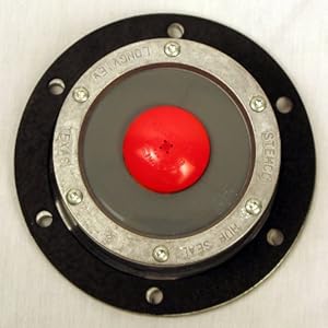

Just how full did you have that hub?
I had the oil about 1/2" up the clear plastic.  This meant filled almost up to the filler hole.

If you look very closely at the plastic part you will find in small print where the correct fill level is.....you might need reading glasses to see it.  ;D

in my experience, it is pretty hard to overfill them. i think stemco pretty much calculated the maximum amount of oil that one can put in there, there are quite a few different hubs and caps in their catalog for different applications. 3/4 inch and 1 1/8 comes to mind.
if the fill mark was the only acceptable level, they would all have the bigger cap.< in other words they are pretty much idiot proofed (That is a figure of speech and is no-way meant personal)
you may notice that there are no indicators here other than the plug
some caps are vented, i would say that the amount that leaked out from the "overfill" could still be an indication of a bad seal, or closed vent
speaking of which, anybody buy the plugs by the case...they are about 99cents each by the box and $4 each plus shipping by the each... :(

The hub oil with warm up and if it's overfilled it leaks out until reaching a comfortable level. Mine did this every time I filled them or changed the oil. Once it found its nominal level it stopped leaking.
