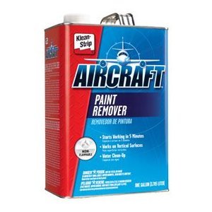

There is a aircraft stripper called Mar Hyde I have used it on two projects. works extremely well.
On the front of the jug is a lear jet  so it should be good enough for us. :)

 Do you intend to repaint or attempt to polish the surface?? most polishing attempts are not feasible due to finding bondo under the old paint.. Aircraft stripper (a trade name) will do you a good job, but its always a lot of work to prep and repaint, but you are usually left with no choice.. After stripping rinse well and let fully dry, then prime with a self etching primer.>>>Dan

Klean-Strip aircraft paint remover is the best a individual can do @ 40 to 50 bucks a gal don't waste your money on the Rust-Oleum aircraft stripper @ 20 bucks a gal cheaper but takes 3 times longer and 3 times as much of the product.The pros are using D-Zolve but they won't sell to the public and besides a 5 gal pail is minimum fwiw any will streak if you don't flush it in a hurry
