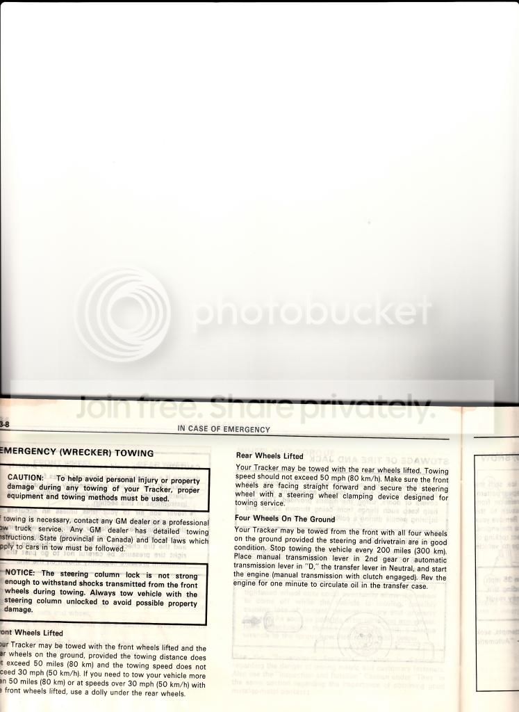

Could be iffy.  My Geo Tracker 4X4 auto trans can be (and is) towed 4 down with the tc in neutral but per the owners manual must have the engine and trans fired up every 200 miles to lubricate the tc.  Hopefully I'll find a cheap driveline disconnect for it some day, but I usually am ready to get out of my bus after 200 miles anyway so no big deal.  Jack

The Tracker/Sidekick 4x4 if like my 1993 Sidekick turns the front and rear drive shafts when the t-case is in neutral so you don't need to run engine. The front shaft is located in the bottom of the t-case so when it spins it picks up the lube and transfers it to the top gears. if you have auto-locking hubs you may have a problem. Sorry for the departure from the original question just trying to help the Tracker/Sidekick owners. HTH. Glen

Scott, with all due respect, wouldn't it be safer to find out for sure if a specific vehicle can be towed four down---rather than finding out it can't be the hard way$$$$$$$?  The 96 Land Cruiser may well be able to be towed four down for all I know.  As an example, I do know that my Geo Tracker 4X4 can't be towed four down without taking some specific precautions as outlined in the owners manual and shown below.  Jack
I agree 100%.
