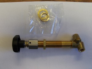

A hand primer (like I have) is a simple plunger/barrel type that the knob unscrews to let the pump stroke facilitate. mine has a 1 1/2 inch stroke. works every time.
Additionally I carry an old (very old) Cummins fuel primer pump off an early/mid 60's Kenworth it is about a 3/4 inch barrel with a 3" stroke....an oldie but a goody, re-primed many a Detroit in my career with it.
were I you I would get and adapt a hand primer if i was going to be a Detroit owner...best thing you'll ever do.
you can get one here:
http://www.ebay.com/itm/like/220885385970?item=220885385970&lgeo=1&vectorid=229466
additionally, it will help you to troubleshoot...if the engine will run off the handpump....which it should/will....you can eliminate the filter condition as the problem....leaving the engine driven transfer pump or the filter prime as the problem.
Additionally,if you were to put a tee in the suction side of the handpump, to prime from a 5 gallon can, you would also determine if the fuel piping downstream of your filters was sucking air, (for instance, a bad pickup tube in the tank) causing the/a loss of prime.

Quotewere I you I would get and adapt a hand primer if i was going to be a Detroit owner...best thing you'll ever do.
Eagle19952:  I took your advice and ordered one up.  Only question is just where do I plumb this in once I get it, and can it be a permanent install?
Mike
1983 MCI MC9
Vermont
suction/inlet side to the downstream fuel line from your tank and
output side to the secondary filter feed...
you'll need some hoses and fittings...
and yes, it is permanent.

iirc #-6 Areoquip is what you want.
i would not use barbed fittings.
most NAPA stores can make the hose.
