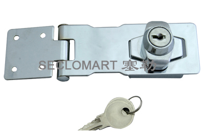

Audiomaker
Would something like this work?

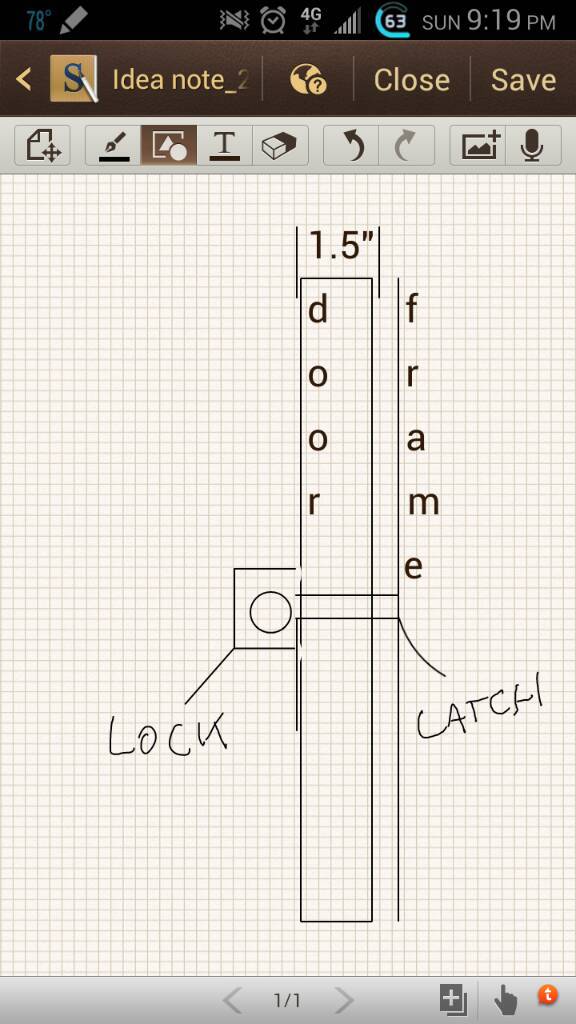

Seangie
Sean - here is a picture to describe it...Ill take a few pics and post them later...

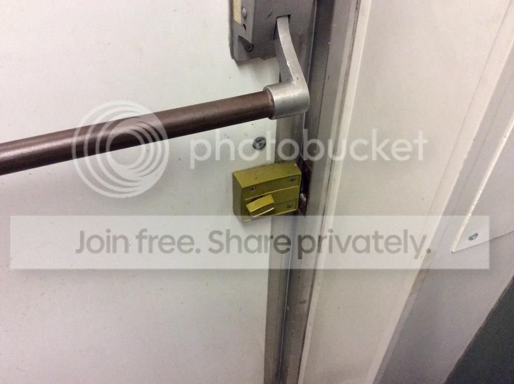

Seangie
Here is a pic of the door.  Its not the thickness of the door itself but rather the frame.  You can see in the picture how the rightside frame of the door has been all hacked up.
I'm thinking that easiest way to do this would be to drill a hole through the frame where I could insert a latch with a 4-5" backset.  I would like to reuse the existing RV style handles that I currently have.  At least on the exterior of the door.
I'm trying to keep it simple but its not looking too promising if I want to get it done right.

Audiomaker
Honestly if it were me, I'd try to repair it (or un-hack it).
