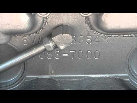

sparkplug188
I just found mine near the end of the exhaust manifold on the side opposite of the starter.  It was covered in no less than half inch of grease and oil.  If you're having trouble reading the numbers, try taking a picture of it with your phone.
Larger Resolution Version

sparkplug188
I am not 100% sure, but I think it would be a little higher up than your circle.  Watch that video again a few times. It took me nearly two hours to find mine-- keep at it, it is there...somewhere.
https://www.youtube.com/watch?v=2dolBw-b_n4
