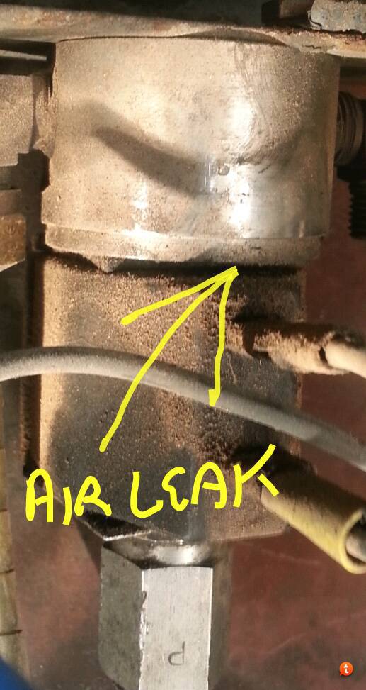

One leaks between the plastic top half and metal bottom half.  I can hear it leaking and feel air coming out.  It leaks less if I turn the bottom half as if to tighten it but it still leaks.  The other one isn't leaking but I figured I'd replace them both at the same time and keep a spare.

I am thinking that repair kits are all you really need....and then probably only O-rings. I don't imagine the solenoids and valve bodies could be the cause or your troubles. And they are not that hard to inspect....tho I would have a few spare parts when I looked, if I could.
I don't think it would hurt to look inside.
PS the kits are 50-60$. I have no idea how much the valves are but my guess is 3-4 or 5x's the kit $$.

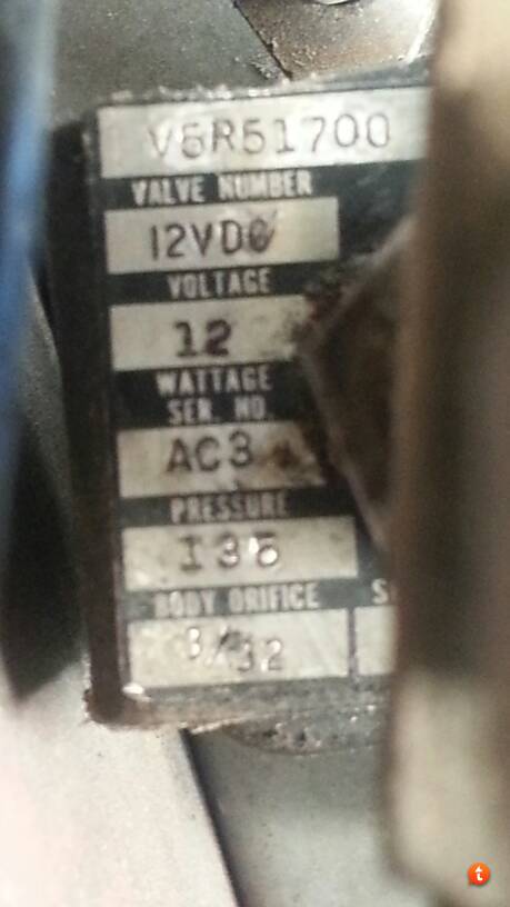

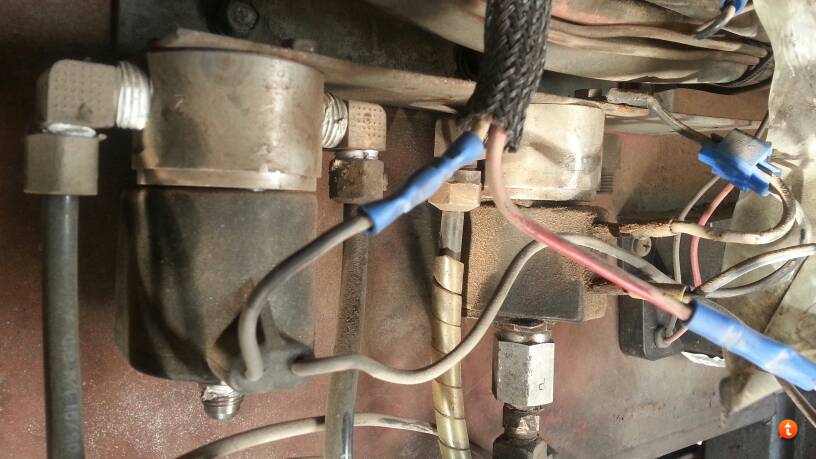

Seangie
Here are some pics and a part number plate from the one that is leaking.

Still wondering if this part# is my only option or if there is a newer numbered part to replace part # V51DA2150 or if that's the only part that will work.
