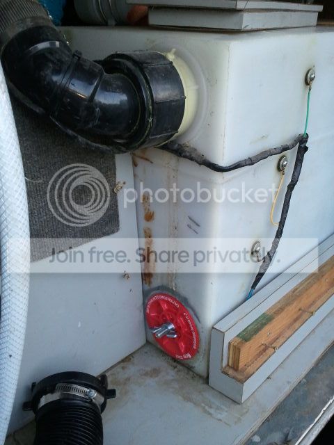

lvmci
Here's a pick of the outlet, 3 3/4" hole, 4 1/2" imprint of the threaded female piece that broke off, tom, lvmci...
MCI 102C3 8V92, Allison HT740
lvmci
here's the inlet, a duplicate of the outlet from the top of the tank, a wider view and a pick of the oakley stopper, from hd, to plug the hotel, lvmci...

  Sorry about your luck, that sucks..I hope the tank was mostly empty at the time, as, even though it wasn't your fault and if the tank was full, Calif. would have declared the spill as a major environmental disaster with mega fines. How about a threaded flanged outlet, inserted from top of tank and installing nut and gasket to seal and go from there? (after cleaning up and smoothing surface of bottom side of tank so gasket will seal properly). If outlet is too close to corner, is it practical to shift tank out a little for clearance?
Buy the plastic welder from H/F for 50 bucks with the correct rod material for the type plastic and weld the sucker it's a fairly good little welder for the money the 14 dollar one is junk

After seeing the pictures-it looks like you could have a new fitting spin welded back into place. I would suggest you call at Ronco-plastics in Irvine and send those pictures to see if they are willing to spin weld a new fitting in. The web site is www.ronco-plastics.com  Good Luck, TomC
Spin,fusion and rod welding are about the same with plastics it's all done with heat spin welding is heat caused by the spinning of the fitting then if fuses together I doubt a spin weld would hold on a tank that old the chemical make up has changed over the years
