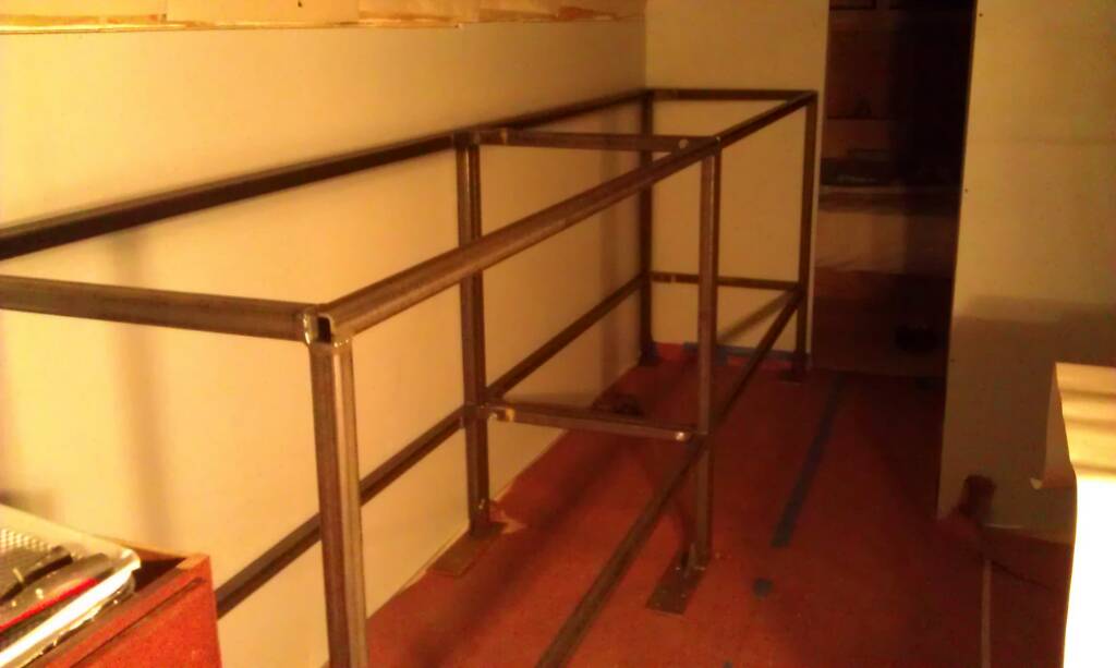

I am struggling with this myself.  I'd like to put the ladders toward the front where the feet are but I'd also like to use that front space of the bunks  to build some shallow magazine like storage shelves for the kids books and craft and toy stuff.

Quote from: Seangie on February 14, 2013, 05:39:58 PM
Brian,
Doing this made me think about moving the ladder to the middle.  But I think the middle of the bunk or the back of the bunk would get in the way of the person in the bottom bunk.
Maybe I can figure a way to put the ladder on spring loaded sliders so the kids can slide the ladder up when not in use.  It could double as a rail so the little ones dont roll out of bed while sleeping.

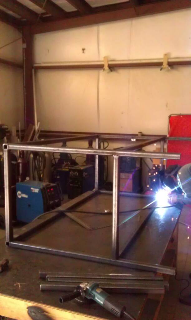

Did you weld those bunks inside the bus?  I  need to re-work my bunks and was thinking about doing metal bunks, but a 34" wide bunk won't fit through a 28" door.  It isn't practical to remove a windshield because they break easily during installation.  I suppose I might get them in through a side window.
Seangie
Brian,
We welded all but one side (the side up against the wall) outside the bus.  For that one side against the wall we welded 3/8 steel corner brackets at each corner of the frame (4 per frame) to slide right into the other side of the frame.  Where the two frames come together in the center the pieces are bolted together through the corner brackets and frame. The outside corners we welded in the bus but we just welded the corner brackets to the outside frame.  That made it really easy to get to once the frames were in place.  We used fire blankets opened all the windows and had a fire extinguisher ready to go as we welded the frames in the bus.
For the feet we welded 3/8 steel plates with corner braces for strength and then we drilled holes in the feet and put a matching steel plate underneath the bus so that the plates had holes on either side of a piece of bus frame and then bolted them together sandwiching the frame between 2 plates.
The bunks are 30" x 72".  Not really big but great size for the kids and my wife and I both fit in them as well.
Glad to answer any other questions you have.  I'll post more pics when we get the face frames done.

Sean, why did you have to weld anything in the bus?  The first picture you posted seems to show the bunk frame completely welded up outside of the bus.
My bunks are quite a bit larger than yours at 34" wide by 80" long.  In hindsight I would rather have four bunks 75" long and 4 bunks 80" long, but I already have the custom mattresses made so I am not changing.  Even just 5" of space can help.
