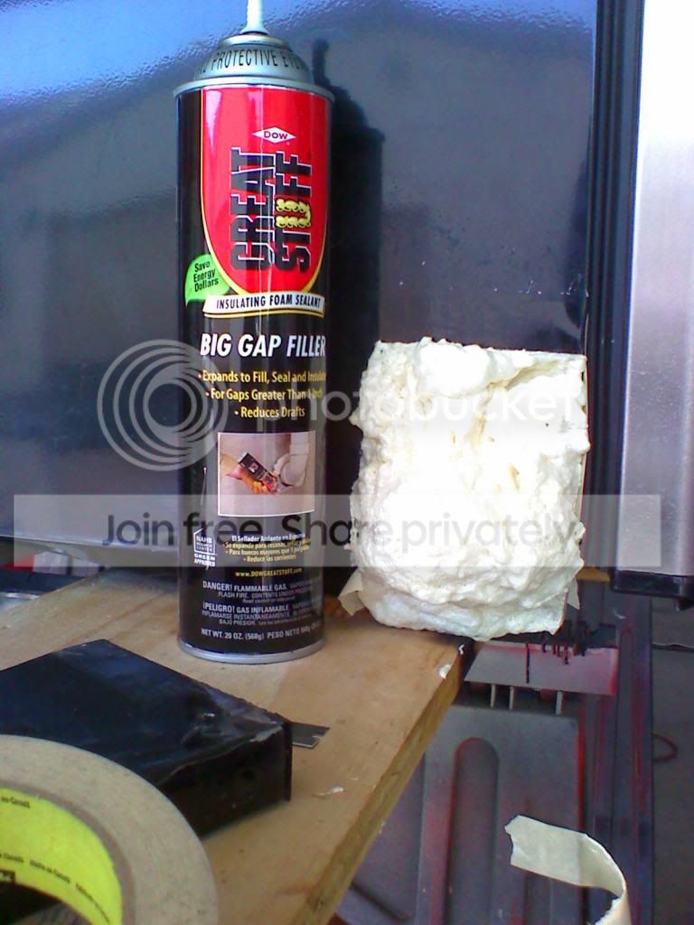

Sealed ours using this stuff, made a backing plate and back filled it up. I don't remember whether or not it is fire resistant  , but if there is a fire in the engine bay it ain't gonna matter much lol.
in this picture, used the foam to seal up a repair area on a fridge.

The same company makes the fire proof foam,, its a pink color, simular can..>>>Dan
