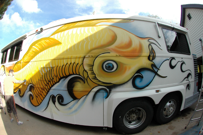

From your pics, it looks like the artist just used rattle-cans? I'm pretty sure I could get that done around here, too.  What I'm curious about was your surface prep and roll-on job.  How'd you do that, and is your base white coat nice and even?  How did you do your clear coat?

 The driver side is finished, complete - clear coat is next. Check it out!
I used the same HyTec Insulating paint called Bus Kote that I used on the roof. It is an elastomeric paint with insulating particles. It looked good on the roof, so I just used on the side too. It is a bright white with a flat finish. I used a Zinser 123 Bullseye primer and both primer and Bus Kote were appled with a short nap 1/4 "roller and a good cut-in brush. I used the roller to texture the brushed areas. The roller creates a slightly rough or textured finish, so it is not a smooth flat finish as you would see from a spray job. However, I was OK with that look - it gives the bus a sort "suede" look.
The clear coat will also be brushed and rolled to give the final glossy finish.
This paint can be sprayed and you would get a smoother look, but I don't have the facilities or the skills. I did the entire job outside on the driveway.
The Koi is a rattle-can job as you guessed and it took the artist Stormy 2 days to complete.
