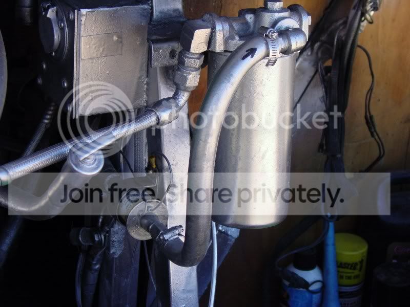

Here is the type of pump I used.  I used the 24 volt one.  I just put it in line in the main fuel line to the primary filter, on my 8V71 I don't think there is anything that will be hurt by 10 - 14 psi for 10 seconds...   I just run it for a few seconds, you can hear when it reaches pressure and that means everything is full.  If I leave it on, the fuel pressure switch stops the engine from turning over.  I suspect that your main line check valve needs servicing.

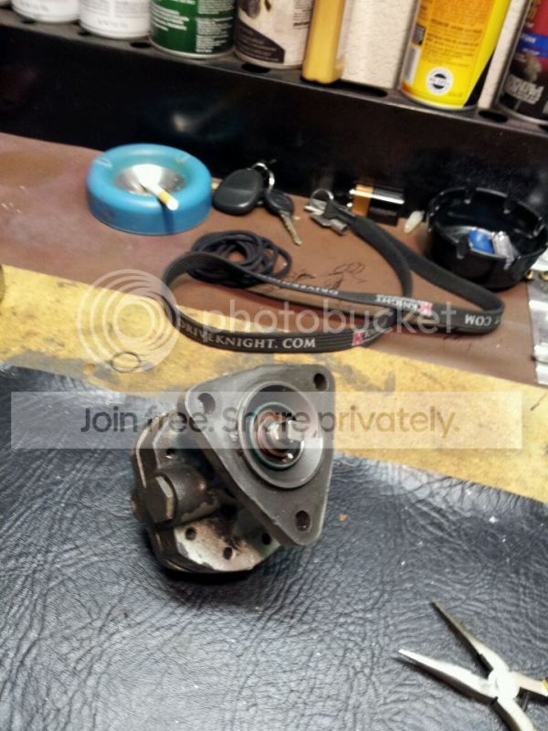

I can tell you what the fuel pump does not like, and that is to be starved for fuel. I have one with a sheared drive gear shaft (sheared within the pump housing) that I pulled from my old 6-92 in Amarillo bringing the coach home. I was having the same issue LarryH was having (in the other thread) in B-town Ca. cept that I had a collapsed supply line to the primary, which starved it of fuel and lubrication to the drive gear shaft. While stuck in Amarillo waiting for a replacement to come in, I pulled the old one apart and to my amazement, the shaft was separated from the gear and pulled out of the housing. Here's some pix.

My Primer is installed inline, before the primary filter. Almost 5 years, and no problemo's ;)

dougyes
Van, What model primer pump is that in the picture?
