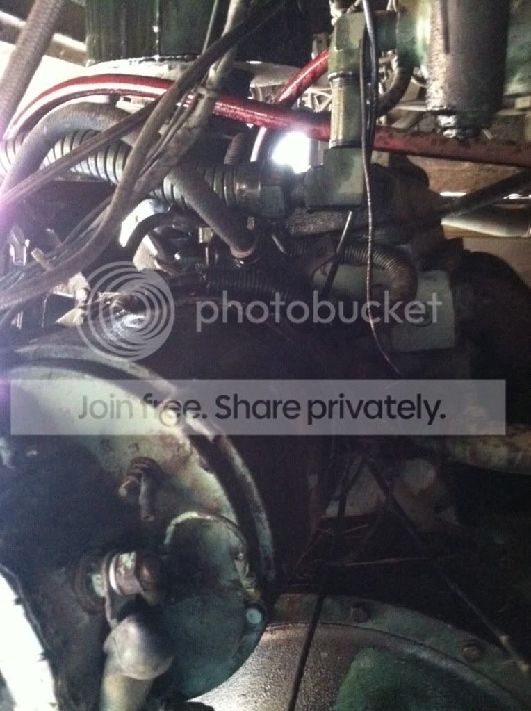

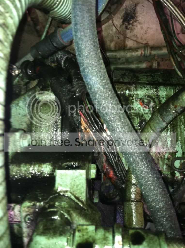

I've heard of the gear driven 50dn horror stories, but I didn't think it happened like this? The "head" of the alternator fell off taking the oil line and some wiring with it. I don't think "head" is the proper term, but it is the bulk of the 50dn, not the part attached to the engine, if that makes any since. At least this happened while at home and not on the road. Can't get a hold of my mechanic today, and I'm fairly certain that I don't have the skills to fix this, but I was hoping someone would come along and give me an idea of what happened here? Thanks guys.

It sounds to me like the cover over the diodes which keeps oil circulating around them has fallen off. As I remember this is held on by a few bolts or screws and just needs to be fastened back on with a new gasket so it doesn't leak.
I can't tell much from your photos, the second one looks like all is well?
To me the first one shows everything normal?

I wish it was just the cover, Gus. I know it's hard to tell from those pics, but the "bulk" of the alt. has come loose. The part that bolts to the engine is still there, but the "rest" of the alternator slides in and out on the shaft. When it broke loose, it severed the braided oil line to it and cut several wires. Look closely in the second photo, you can see the gap between the alt. and piece that bolts to engine. You can see the gap in the first one too, it's just behind those wires.

The oil is from the feed line to alt., it was severed when it broke loose from the engine, spraying 40wt all over. I definitely have questions as to why this happened, but not placing any blame yet.

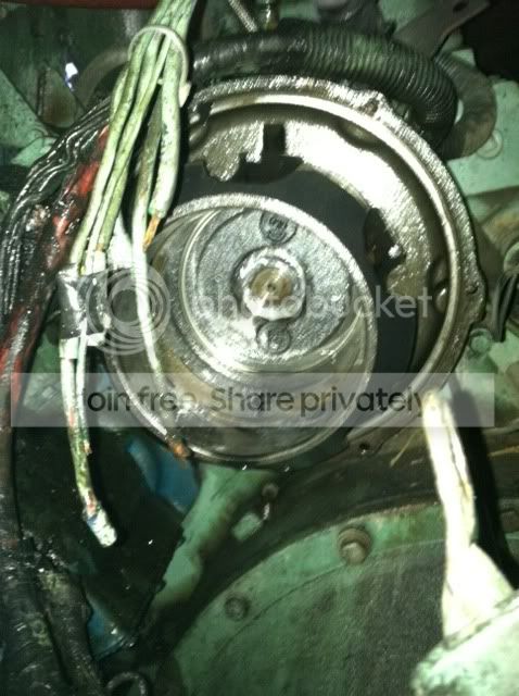

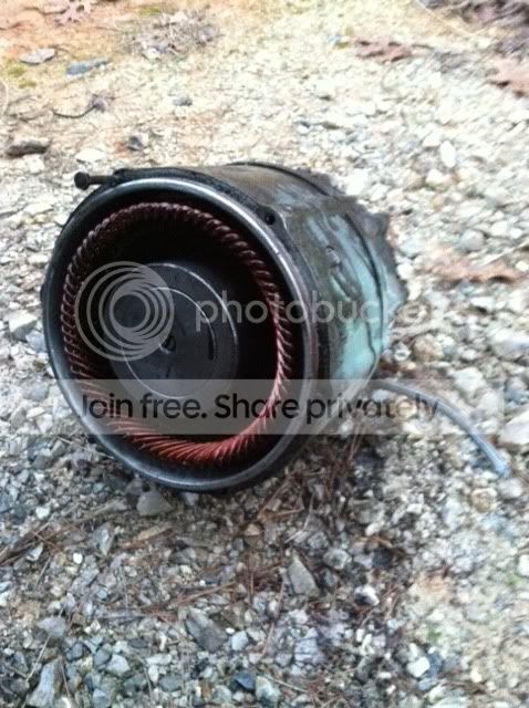

Here's a few pics of what it looks like now. Only one of the 1/4" bolts that held the head on was present, and it was backed all the way out. Doesn't appear to me that they broke, looks like they all worked their way out somehow?

Brandon, that had to happen all at one time a loose bolt those things leak and you would have noticed it, check your drive careful I hope no one just installed a drive on a standard cam and mickey moused the drive those need to be installed right
I preached to this choir here before about the 50D it is a bomb waiting to explode if not taken care of,Boomer will give you good advice as I remember every 100,000 mile they did a inspection and maintenance pulling alternator and changing the drive think I read that from him.
I don't see where the guy that did the inframe could have anything to do with that it would be no reason for him to be in that area unless he did a parts swap from your other engine
.Hope it not a hard fix and no damage to the gear train you can tell  when you remove the rest of the alternator fwiw every time you shut the engine off the alternator gets a back lash it's the nature of the beast sometime it breaks the cam
