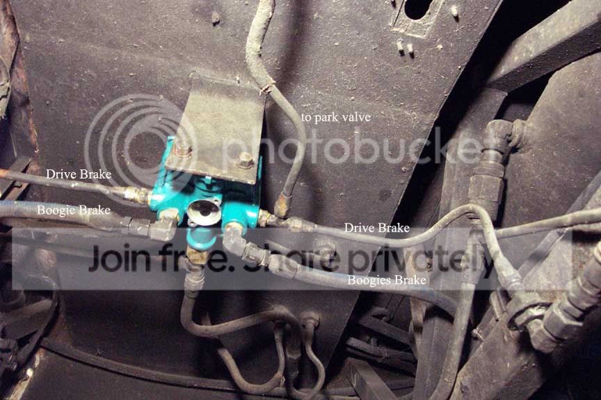

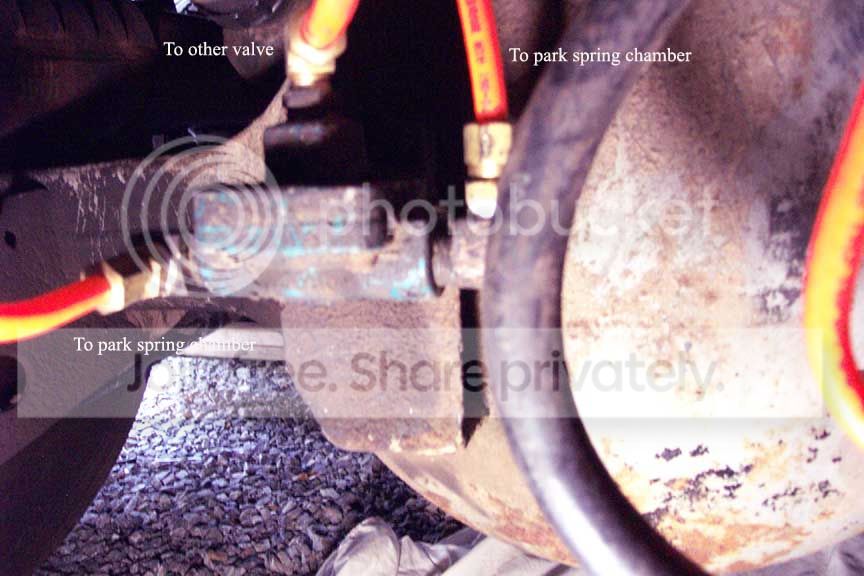

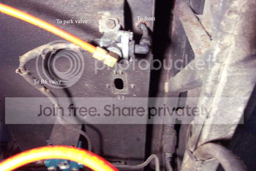

Cary and Don
This is how it is plumbed.
Hope this will help to tell what we have.
Don and Cary
1973 05 Eagle
GM 4107
Neoplan AN340
1973 05 Eagle
Neoplan AN340
Cary and Don
We are trying to fix this without undoing all those lines.  This will be a real bear without a pit.  So far, we have had real bad luck with getting those old compression fittings to reseat. We sure don't want to change all those line fittings.
