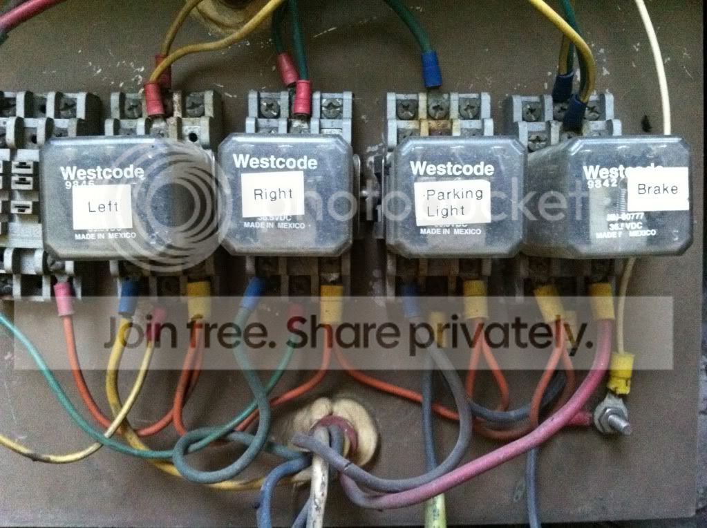

I vote for using relays... This is how I wired my bus, I have had no problems with it yet. I always have a trailer behind me or the toad.
I read here someware about two weeks ago, someone said there just aren't enough pictures on this forum. So here is a pic of how I wired mine.

The converters you have already tried use diodes to isolate the brake from the signal on the bus side.  You've already proved those systems don't work so what the guys are saying is that relays are the way to go.  It may look complicated but you're just driving four normally open switches with input from the signal lights, the brake lights and the clearance lights.  The difference from the converters you have been trying to use is that the relays should be more robust.  I'm not sure why the converters aren't working for you - about the only reason I can think of would be that your trailer has a particularly heavy draw which is exceeding what the converter is capable of passing.
