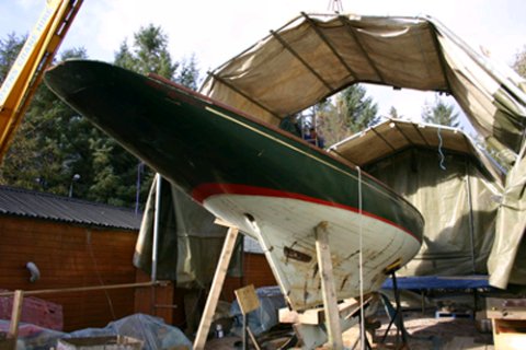

On the stability issue - in fact, although it's often assumed that width gives stability, that's not really the case at all - the length of a vessel is by far the most important factor in determining it's stability, and in this respect the bus ferry obviously score highly. Plus I expect it's got a lot of weight low down in the chassis, beneath the waterline - although the high body above the water isn't ideal, it's the centre of gravity that actually matters rather than the physical height. Think of a classic sailing yacht - narrow and very high, but very stable due to it's length, and with a very low centre of gravity due to a big keel. Modern yachts - shorter, wider, smaller keels - are fundamentally much less stable than the old-timers.
Long, narrow, probably taller but low CofG due to big keel = stable:
Short, wide, probably less tall but higher CofG due to small keel = less stable:
