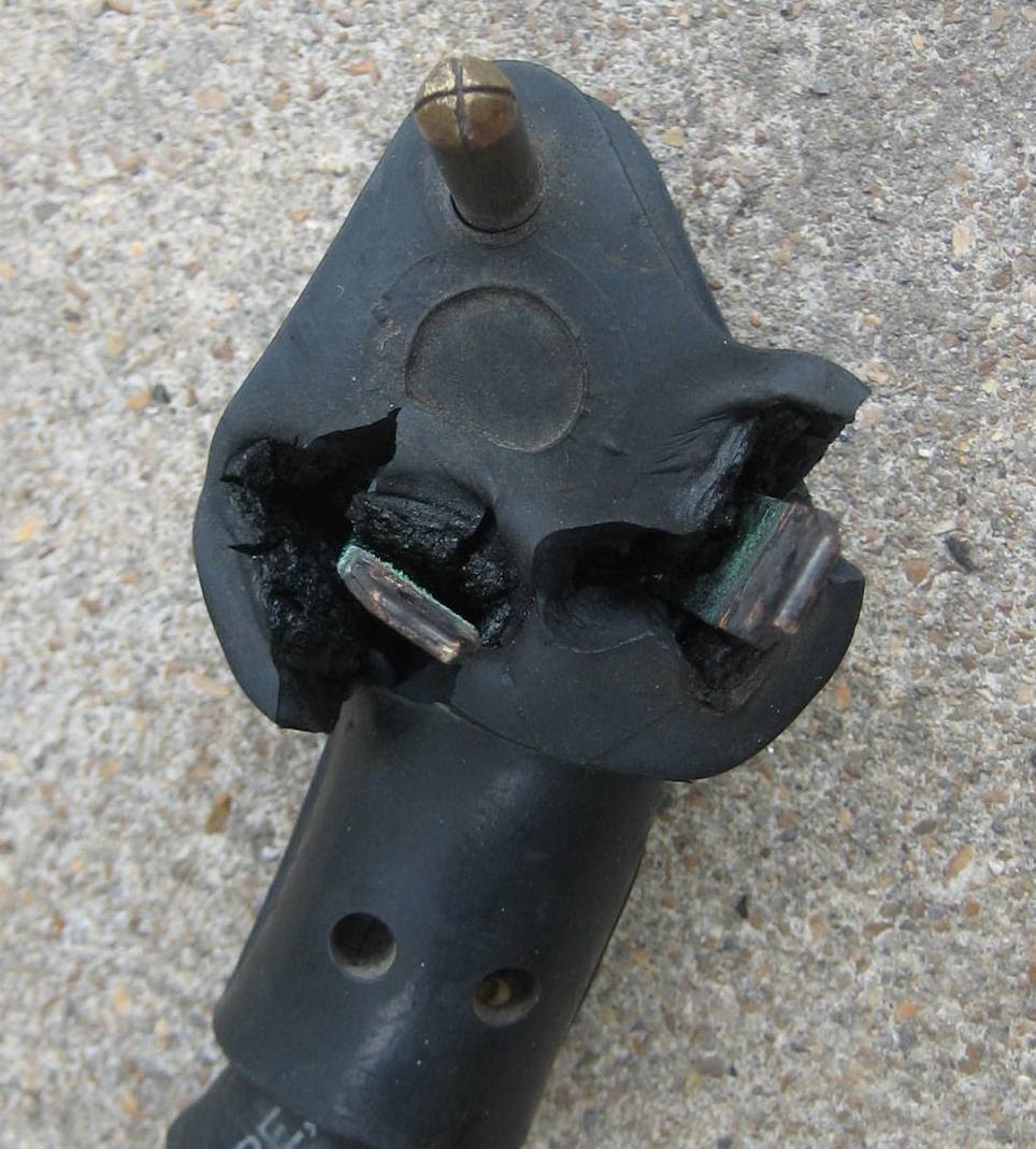

To give you some sense of the temperatures involved in these connections and what they can do, here is a photo of a 30-amp adapter that was in normal use for three weeks -- carrying only 20 amps continuously.  The cord was hanging upside-down (the receptacle was installed that way) and you can see the blades have melted right through the plastic:

  In all seriousness, any RV 30 amp plug that would overheat at 30 amps to the point of failure, is very poor quality. To do that on a 20 amp draw is simply detestable. IMHO, no electrical service cords, plugs or receptacles should ever get so hot you cant handly them. If they do, you have, or will soon have a problem.
I submit that you don't get around much.  Any TT-30 plug can overheat due to a constant draw of 20-30 amps in hot weather.  I see these failures all the time, both on RVs and on boats.  All it takes is a bit of a loose tang in the receptacle -- and you, as the guy with the plug, have almost no control over the receptacle, which belongs to the campground/repair shop/Elks lodge/whomever.  Sure, a low-quality plug can contribute to the problem, but I can show you spec-grade Hubbell plugs that have melted cases due to electrical heating.  So, no, it does not mean the plug was poor quality.

The conditions under which the tangs on these plugs heat up to the point of being almost too hot to touch are actually fairly common and I do not consider "normal" ohmic heating of the plug, by itself, to be a problem.  But it's definitely not a place to use solder, either on the wire ends or on a terminal.
