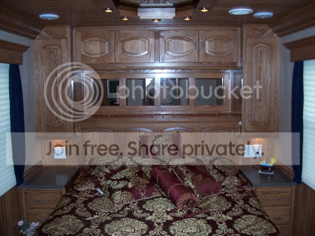

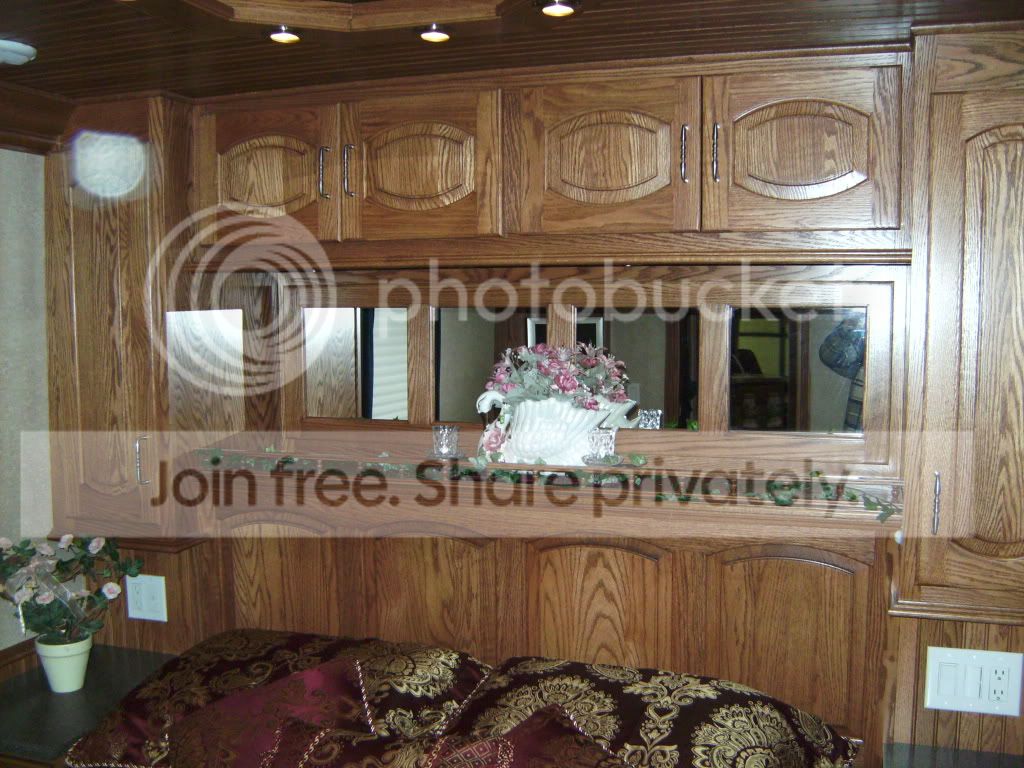

I don't have any pictures of how I framed it up, Just of the finished area but my headboard is the wall of the radiator and fan housing then it steps back for a shelf and the mirror is hinged and there is about 8"-10" of space behind it where I can get to the rear lighting and backup camera wiring. Then the bed and night stands cover the first hump in the floor and the bed hinges up to get access to the service holes in the floor. Jason
mike802
Wow Jason, that looks great.  Cant imagine mine looking that good at this point, I like the hinged mirror idea for access to the wiring.  I will have to change my stud work, but I think it will be worth it at this point to incorporate something similar in my bus.  what did you do for insulation behind the mirror?
Mike
1983 MCI MC9
Vermont
jmblake
Thanks Mike, We had our hole bus spray foamed and that made everything realy tight and sound. Jason
