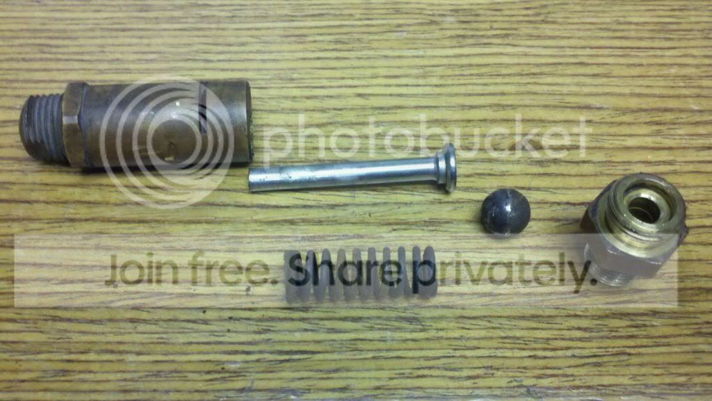

I have found lately I would get up to 90# of air then it would slow way down and take a little while to reach the full 120#. I found the pressure relief valve on the air dryer was lifting. I tapped on the pin and it slowed way down and air shot up like normal. After a minute it started to blow again but held pressure. I pulled the valve after the bus bleed down the next day to clean and look at it. What I found was a rusted and pitted ball check in it. I can see it has 150# stamped on it but not a CFM. Now I see the things come in all kinds of CFM ratings. What do we need? They cost from $8 to $80. The one thing that I will change is that it points down so any moisture that gets on top of the ball sits there and causes it to rust.. These should be nondirectional so I will install it back straight up. This may be something some of you want to look at.

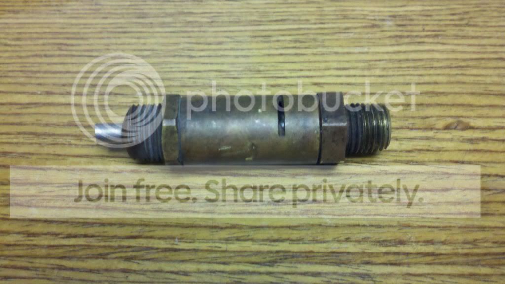

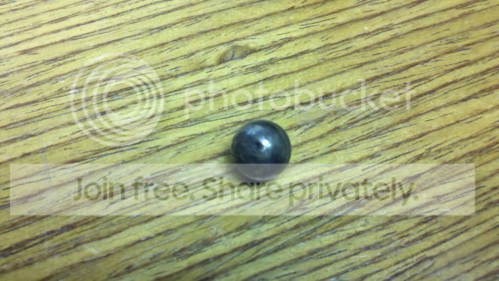

eddiepotts
Here are some pictures if anyone is intrested in how they are built. If I can find a new ball today I will just change it and fix this one.
bigjohnkub
You can get the ball at any Bearing supply store.

eddiepotts
Clifford, You may be right but like a small pin hole in a tank would not stop equipment from rupturing  if you have a large volume going in. So what good would a relief be if it could not overcome CFMs and save your equipment. It would change it from a safety device to a warning device. At any rate I went down to our machine shop and found a big bucket of balls that someone has saved. Sure enough I found what I needed and all is working again. It will be back on the bus tonight and it would be great if it would hold air for more than 24hrs now.
