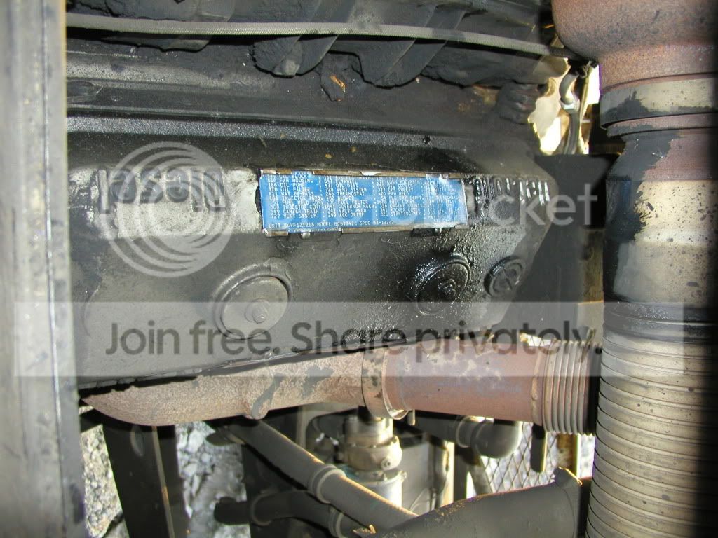

I agree with HB of CJ, abotu wanting to know what your specifics are.  Try and find an engine assembly tag like this:
This tag contains the details of your engine build.  Mine shipped with 7G70 injectors putting out about 277HP when new (now probably more like 200HP...)

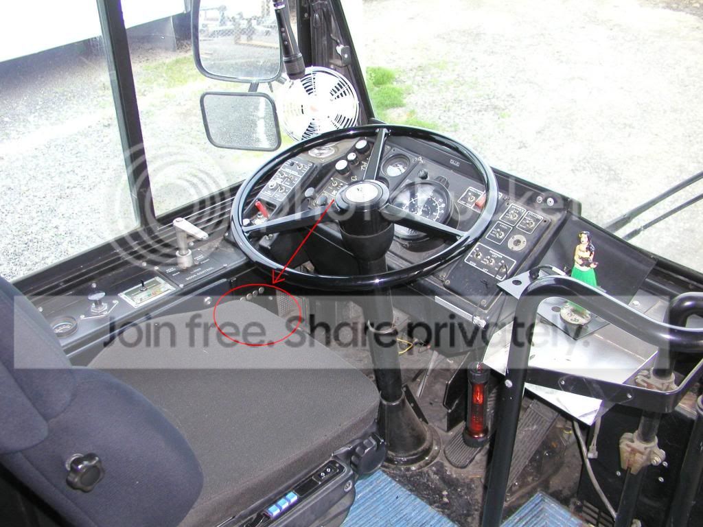

Are you sure the valve is dead?  My bus had an accessory cutt-off valve that would stop the air supply to the door contol valve to allow the door to "free-wheel" when the bus was parked in the transit yard - it's a two position switch so try both before you commit to a new valve.  This is what the whole valve looks like:
All you have to do is push the door closed and push it open when the switch is flipped.  I don't have a picture of my actual installed valve, but the valve was located down here (circled in red):
My door control valve is not in the bus anymore, I can look in a parts boxes to see if I still have it, but I think it was one of the first things to go during the first strip-out.  Gillig Service Parts would be the people to contact regarding the door valve if you can't find it anywhere else.  It will be retail, but the will have it.  They are located 50 feet from the Gillig plant office in Hayward, CA (the next large building over).  I will look in my parts boxes this weekend and try to find out if I still have the original valve - if I do, it's yours free of charge (including Ground UPS shipping).  One less thing in storage is worth the $15 on my UPS account... (the wife agrees ;D).
