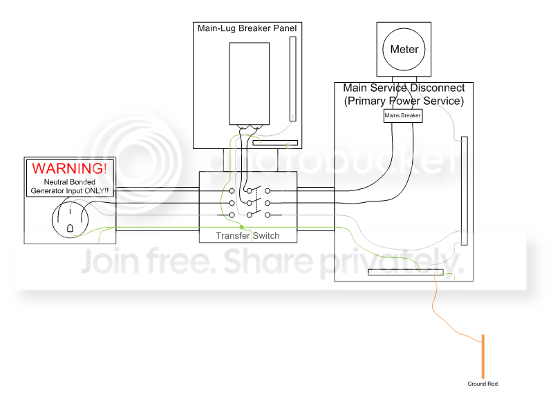

  In my case I intend to have a transfer switch that delivers generator power directly to the main panel, and will disconnect un-needed circuits to keep from overloading the generator. i notice in your drawing you are switching the neutal. I need to call the place I bought the TS as supposedly there is a kit to switch the neutral.

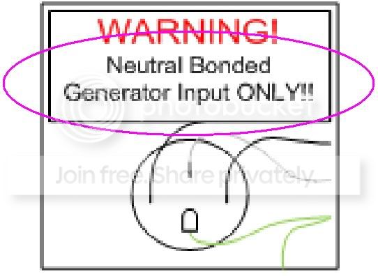

Quote from: artvonne on February 08, 2011, 12:35:21 PM...Okay, but you left out whether the RV Generator has the ground and neutrals bonded or not...
Sorry, should have used a bigger font...  You would need to actually have that warning label on the input plug.
In your case where you wish to power the entire main panel, the same general concept applies - you'd need to have the switch before the main pannel, and would need a main-breaker after the meter but before the main panel and transfer switch to protect the main entry conductors and transfer switch.  The neutral would have to be bonded at that new main service entry breaker, and that main entry neutral separated by the transfer switch.
Like this:
-Tim

So there are two distinct configurations discussed here in this thread:
  • Standby, permanent fixed-installation (hardwire, dedicated to the house - neutral not bonded)
  • Portable, temporary installation (use a flexible power-cord to hook it up then put it away when you're done, take it with you to another jobsite, or vehicle mounted - neutral is bonded)
The "Interlockkit" device is designed to work in the first case since it just switches the hots, but you need a different setup if your generator is a temporary/portable type.
Quote from: artvonne on February 08, 2011, 09:10:05 PM...I spoke to Katolight in Mankato MN...  ...His recommendation was to install a knife switch between the ground and neutral at the generator, so the switch becomes you bonding mechanism. On to bond, as when your running your rig, and off to de-bond, when your powering your house. He said there really is no need to switch the neutral in a non critical system...
They say that, but possibly without context/pretext of this thread (I have no idea).  I actually take issue with their recommendation to install a knife switch at the generator, and here's why:  You will now have to switch things at two locations (one at the transfer switch, one at the generator - possibly with tens of feet between the two devices).  The point of an interlocked transfer switch is to ensure that the system is safe to operate before power is applied.  Two switches that are not directly interlocked adds a significant risk, and operation complexity.
Will you always remember to flip both switches?  What if you're in a hurry one time and forget to de-bond it?  Also, what if you meant to re-bond it and while you were putting away the cord you got side tracked in a conversation and never remembered to re-bond it?  What if you're not the one to hook it up or take it back down, will the operator know that they need to de-bond it or re-bond it?  What happens if someone messes with the state of the bond/de-bond switch separately from the transfer?  How can you prevent independant operation of the device when it's in-use?
It is solely for the advocation of safety that I recommend that if you are really planning on using your bus generator as a house back-up and you are conscious of this in advance (for instance planning to put in an input-plug in a box), why wouldn't you put everything in one device (i.e. the transfer switch)?  This way the circuits are set up correctly by hard-wiring them appropriately for each power source, and any idiot can run the system safely (safe by design is better than safe by memory).
My opinion.
