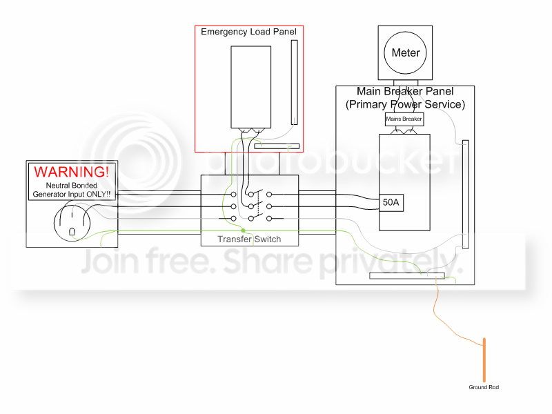

If the generator is to be connected using some type of permanently installed inlet with a transfer arrangement, then, no, you should not remove any bonding jumpers.  Instead, the loads must be fed from a sub-panel with isolated neutrals downstream of the transfer gear, and the transfer gear must switch the neutral.
If you are connecting the generator to the panel with a temporary pig-tail wired directly in to the panel (no permanent provisions allowed with this arrangement), then you need to remove the incoming hots as well as the neutral and tape them off.  The temporary pigtail connects to the same lugs that the permanent wires, now removed and taped, were using.  In this sort of arrangement, if the "incoming neutral" actually originates as a jumper inside this panel, then, yes, you would remove and tape the jumper as well.
Quote
  I have a 200a transfer switch that only switches the hots. If I used the RV to power the transfer switch, and the generator in the RV is bonded, how would you suggest grounding/bonding the transfer switch?
Sorry, but you simply can not use a transfer switch like this with an RV generator, ever.  Not in your RV, and not to connect your RV to the house.  Any transfer gear connecting to a bonded generator MUST SWITCH THE NEUTRAL.  Period, no exceptions.  Anything else is dangerous.
As I wrote earlier, generators made explicitly for fixed backup use are not bonded; they have floating neutrals.  This type of generator is connected with a transfer switch that does not switch the neutral but rather passes it straight through.

artvonne
  Im trying to go back to the beginning of this thread and re-read it. If I am understanding the problem correctly, the best setup would give the Bus its own transfer switch that carries all generated power away from the bus, and which isolates the generator from the Bus entirely?? I assume this would be the type of TS that also switches the neutral? That you could then carry three wire (two hots and neutral) to your home transfer switch and have your ground bonded there?
Tim Strommen
Quote from: artvonne on February 06, 2011, 10:32:40 AM
I think this is what we're getting at (all contained in the structure to be powered by the bus - not on the bus):
-T
