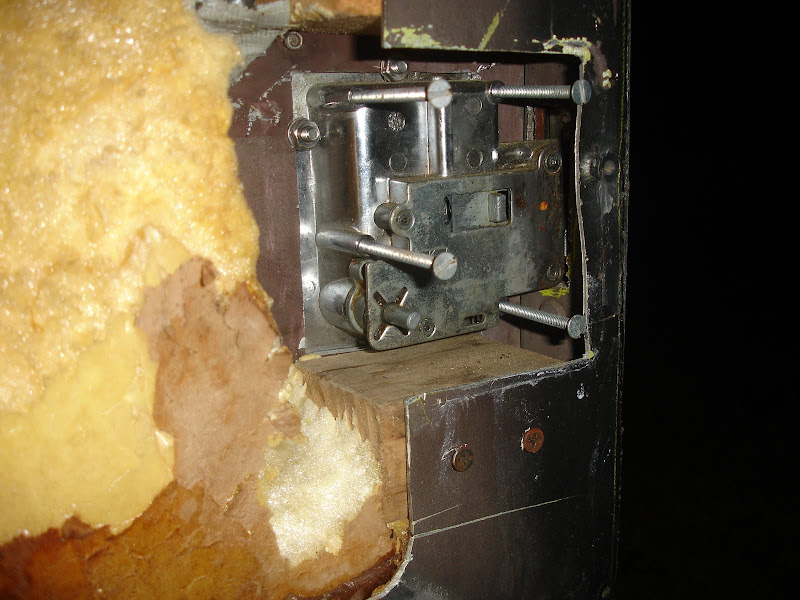

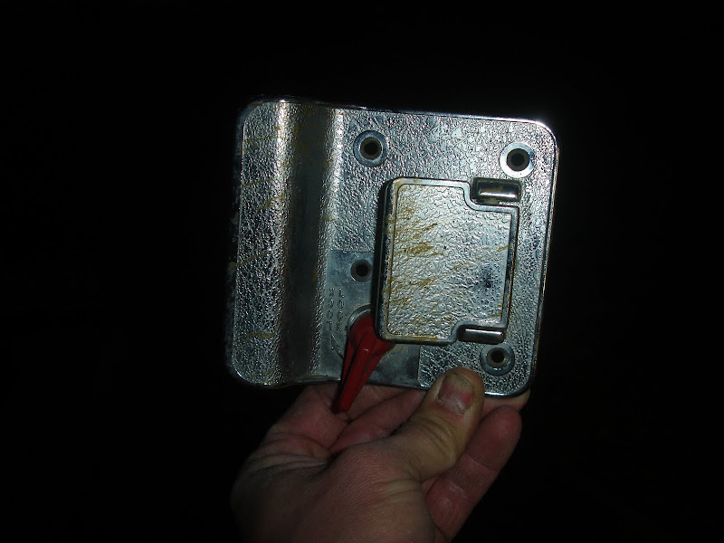

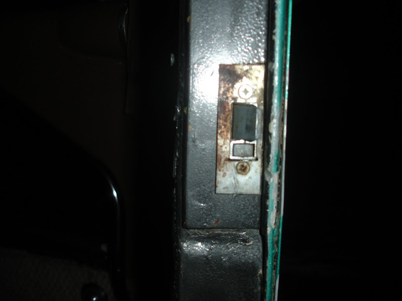

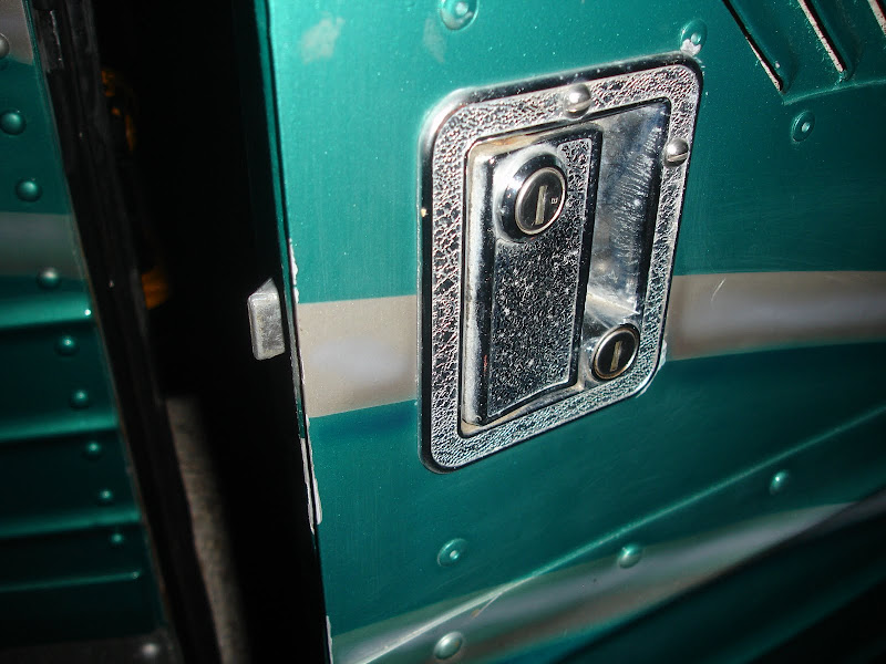

I like the deadbolt option. I may look into that. What I have currently is pictured below....
Outside latch view...
Bolt view...

Inside plate...
This was all installed by the PO, and I feel like he started cutting before he realized that this was no ordinary door construction. As you can tell in the "Inside view..." pic above, there is a least an inch of space between the inside mechanism and the inside door surface. Also, in the "Bolt view..." pic, you can see that it wasn't even centered. This makes for some difficulty when attempting to mount a strike plate.  It would take some engineering to get this lock to work, but I know there has to be a different option that would be more feasible for the given circumstance. It seems that the consensus is to go with a latch/lock designed for an RV. I'm assuming that these will be designed for a thicker door installation?
