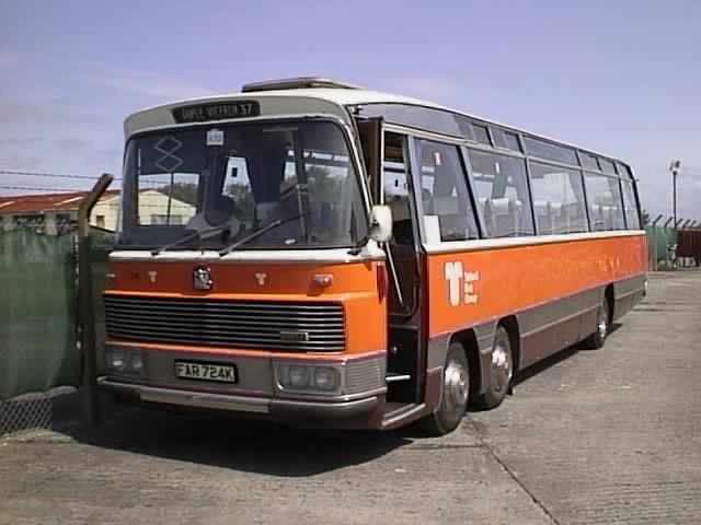

One of my own coach's antecedents is the Bedford VAL, as made famous in the 'Italian Job' movie. They are very collectable over here - there is certainly something very cool about having twin steer axles
