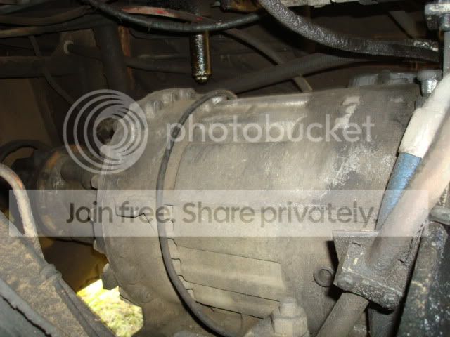

Highway Yacht
The ID plate is there but I can't make out any of the numbers. Here is a picture of what the transmission looks like. Can anyone tell what transmission it is by the picture?

Mike in GA
Yep, that's a 740.
    The 750 series is longer and has a band of protuberances around its circumference that resembles a bandolier or belt of ammunition (at least to me).
    Next week I am swapping out my trusty 740 for a rebuilt 750 close ratio. I do a fair amount of suburban and secondary road driving where 45-50 mph is easier to maintain with that extra gear.

That is an HT740. The HT754CR has an extra gear bolted on the back of the transmission-of which this transmission pictured does not have.
Typically the normal shift pattern is- 1st converter, 2nd converter, 2nd torque converter lockup, 3rd locked up, 4th locked up. Good Luck, TomC
