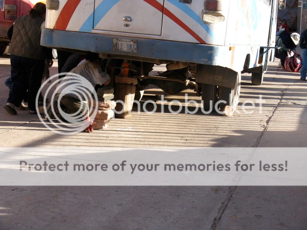

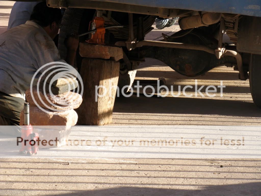

  Oh and here is a pic of some guys in a small town in Bolivia, fixing the rear suspension of a bus using stacked rocks and a bottle jack to lift the body off the leaf springs so that they could reef the broken one out and install a replacement.  I couldn't watch.  The bus was on a hill.  I couldn't watch.
