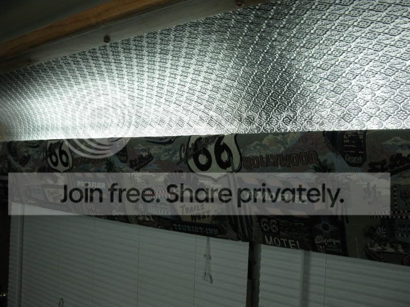

finished mine about 60 days ago. Took some extra work but end result was nice! Layout time was most intense. You will need to find a 30 inch paper cutter on ebay or craigslist. Easy to manipulate and flexed nicely to the original curve of my 9. I have also just finished two rooms for a neighbor who liked the bus so much! I chose zinc self tapping screws and some sealant. As you can see, I also needed to cover the tin as it was raw!
Good luck!
Grant
