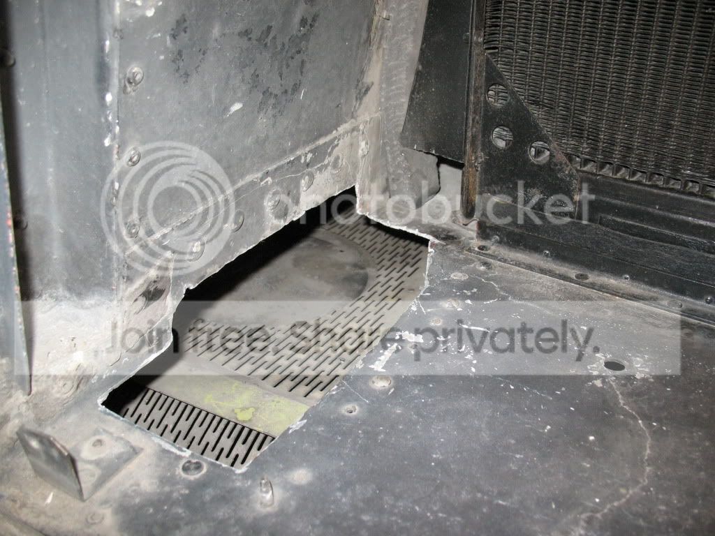

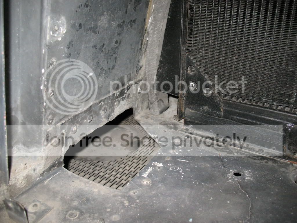

No it doesn't look stock. The bus has MC9 caps, so the air intake was modified. There is a square hole cut in the floor in front of the rad, and it leads to the 7" pipe that goes to the air filter. That cut hole is only about 4" by 6". So I will get at it with the angle grinder to make it bigger. Looks like I can get it to be at least 7" by 7", to match the pipe to the filter. If you see what I mean, the air enters through the side grill in front of the rad. Some air goes through the rad, and some goes down into the filter. I'll take a picture.

And after surgery. It is now about 4" by 11". Almost double what it was before. You can see the old hole below for the air intake duct that was plugged. The current air intake pipe is just ahead of it toward the front of the bus. It is about 4" below the hole I just inlarged.  That should improve air flow. We'll see this afternoon when I go to Calgary. I'll be able to tell by how much black smoke I put out. I have a ECO filter on order.

Now what do you guys think about a duct I could make out of sheet metal that would channel the air directly to that hole from the grill at the side of the bus? At present, air enters through the side grill, then some is sucked through the rad and some is sucked into the intake toward the filter. I don't know which is stronger: the rad fan, or the turbo. Would I gain anything by seperating them to the grill?
